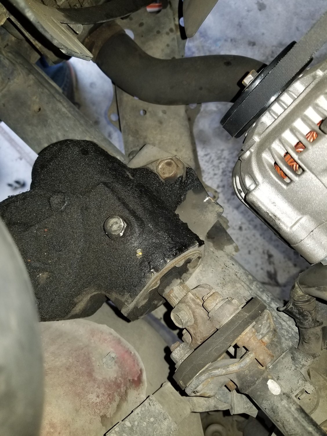

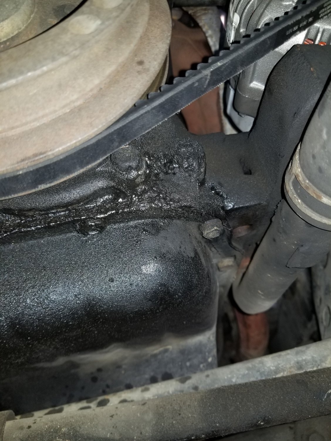

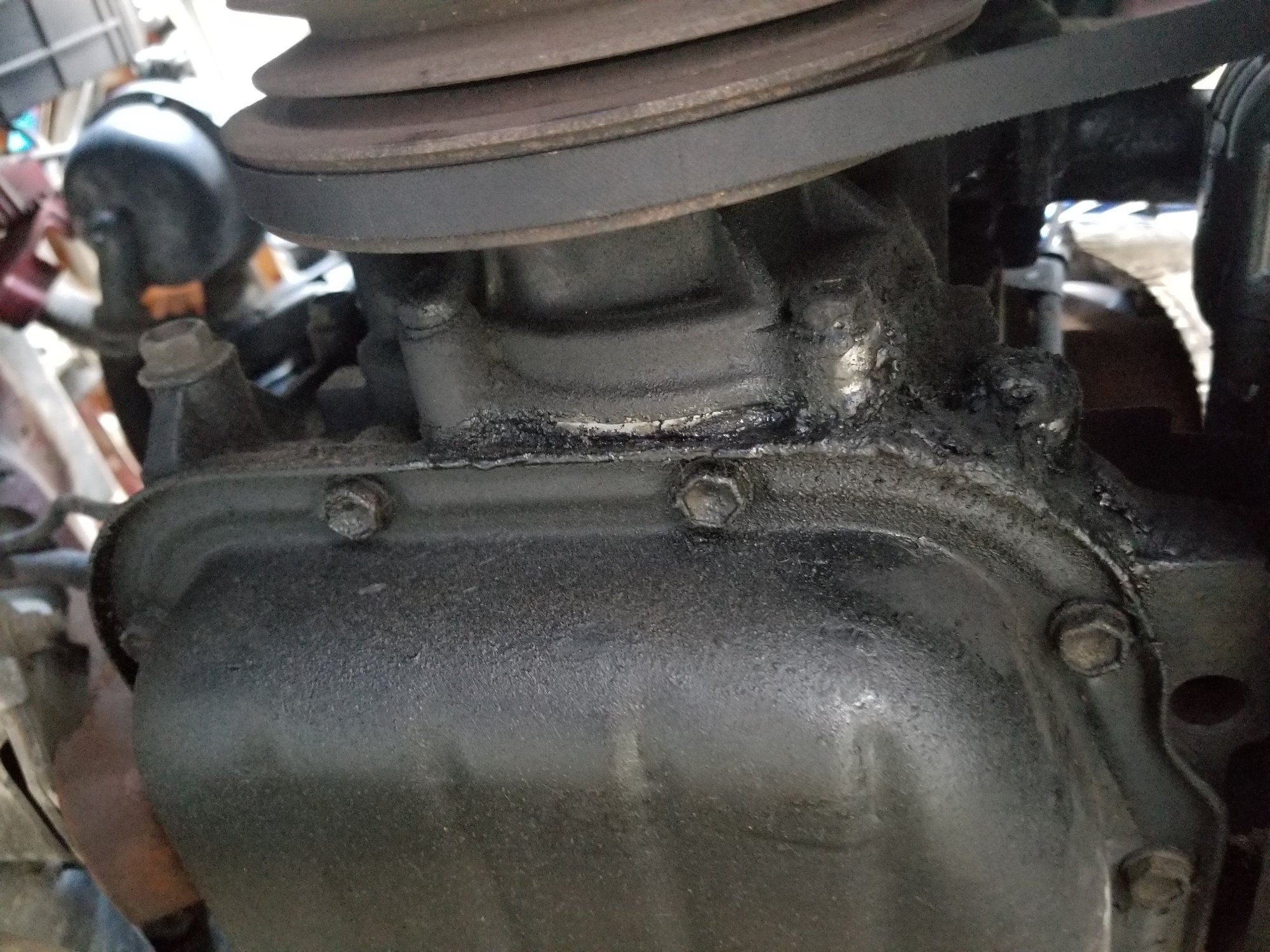

So I posted on here last week about my 22RE seemingly burning oil between changes. I was befuddled by the fact that my spark plugs were clean (checked them again after posting last week, no oil build up), my compression was good (170-175 across all 4 cylinders), and I was not experiencing any blue smoke. I decided to replace the original PCV valve and grommet and hope that this would solve the issue, but as I was doing that, I figured I might as well prod around the engine to see if I missed anything.
Lo and behold, I found a ton of gunked up oil underneath my crank pulley (I'm guessing this means front main seal?) and where my oil pan connects to the block.

1. Does this seem like I'm on the right path? I don't expect it to burn 0 oil given its age, but it does seem to be leaking based on the pictures.
2. I'm planning on dropping the oil pan but not removing the head. I've seen other people on here do it this way - is there anything specific I should be careful of?

Not sure why this is so oily? Is it getting flicked around?

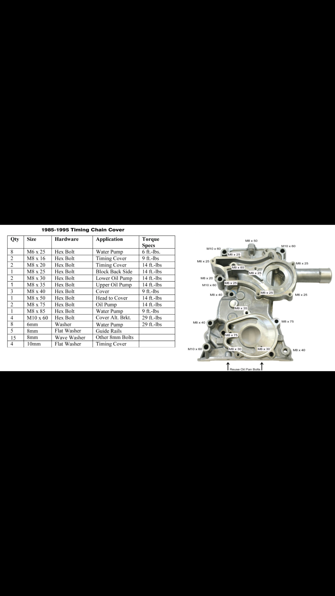

This dude has a three part series on timing chain replacement and he’s a member on here.
https://m.youtube.com/user/TheAlexManVideos/videos
Get a FSM or a Haynes/Chilton manual. Intimidating? Yes. Difficult? These are some of the easiest engines to work on.
When taking the timing cover off be sure to keep track of all the bolts. They’re specific sizes and lengths for each spot.

If you just drop the oil pan to do the chain, make sure to use some sealer on top of the timing cover where it meets the bottom of the head gasket. If you don't, it's going to leak. The new type head gaskets have a rubber bead attached to the bottom of the head gasket that seals that area.
Does look like your front seal is leaking. Check the inside of harmonic balancer for a groove when you take if off. If it has one...probably will...install the Toyota Type T timing cover front seal. This seal is thinner than the original, and rides on a different spot. No need to sleeve it.
