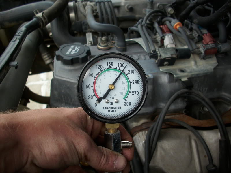

here is mine at 6k miles after rebuilding my motor
nothing to be concerned about as long as its even all the way across

thats what i was told along time ago from a master mechanic and thats what ive always gone by and its never failed me. he said its better to have them all about the same even if it seems "low" of corse within reason. its better than having 3 out of the 4 high and one low cause that could be a sign of internal problems.
