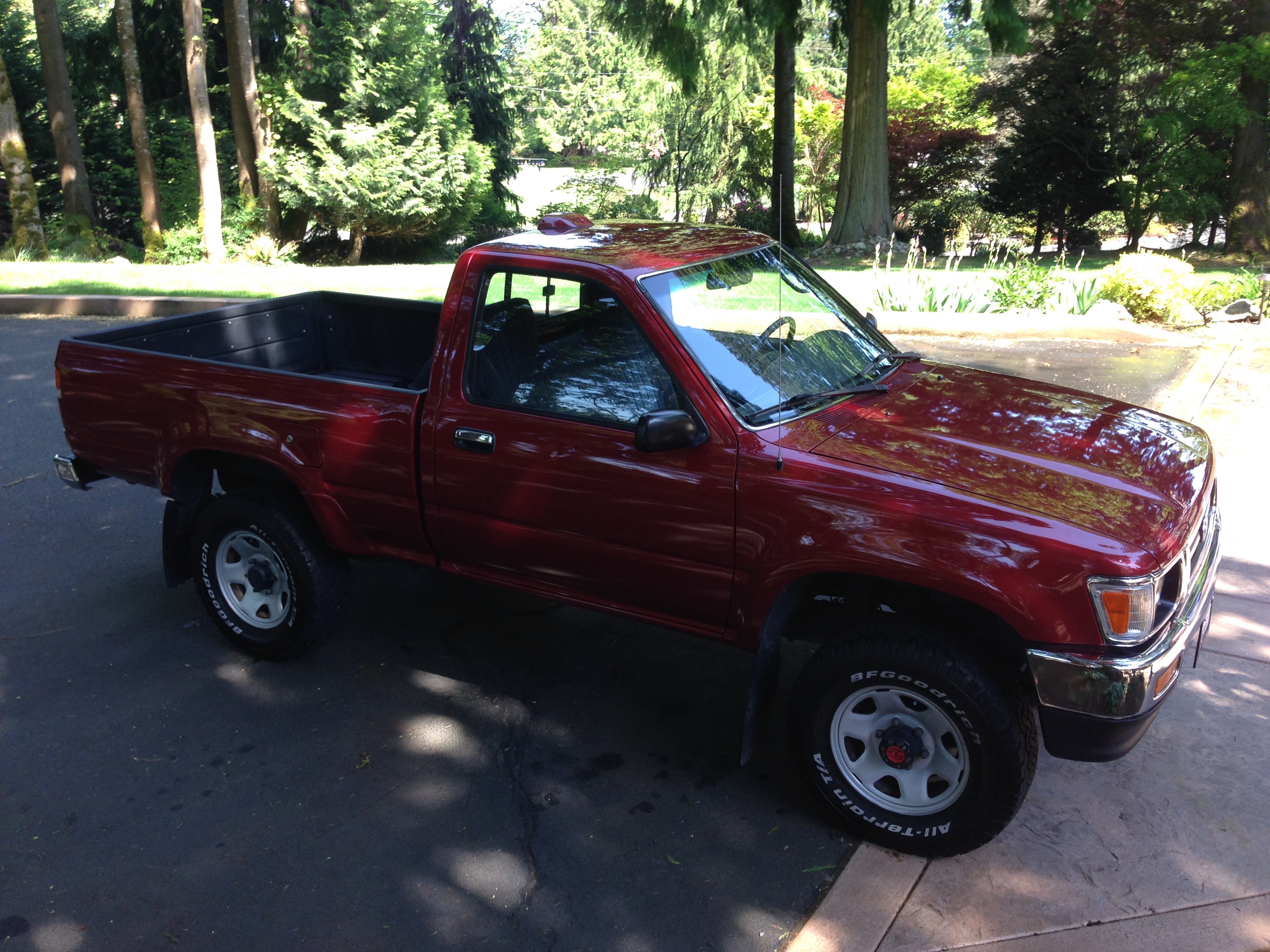

Hi all,
I'm in need of some advice as to which direction I should take with my 22RE.
Here's some background. 1994 Single Cab pickup All original and approaching 210K. Doesn't burn any oil, never had a problem with it. It's been babied it's whole life by me and the previous owner. I have a rocker arm that is tapping, and I have determined that it is back on cylinder #4 and is most likely the exhaust rocker. I planned on getting a new head from ENGBLDR, as well as new cam, and ordering better oiling shafts from 22re performance and OEM rockers from toyota. Since this was the plan, I thought I would do a compression test to get an idea about the health of the block. For compression I got the following.
Cylinder #1 --> 140
Cylinder #2 --> 150
Cylinder #3 --> 160
Cylinder #4 --> 160
With those numbers, now I am thinking that it might be time to freshen up the old 22re. I know factory compression was around 170, so I think Cyl #3 and 4 are doing okay considering that they have only dropped 10 PSI in 21 years. However, Cyl #2 and #1 concern me, especially #1. I added some oil to cylinders 1 and 2 and got the following numbers.
Cylinder #1 ---> 150
Cylinder #2 ---> 160
what this told me is that the rings are on their way out in 1 and 2, and I'm sure that 3 and 4 can't be far behind. at this point, what would be the best options to pursue. I have looked at a the rebuilt engines, but I know they will never match what came from factory, but that being said, there are some very good rebuilts out there, and if I went in that direction, I would most likely go with 22REperformance. That being said, I would like to save my engine, as it has lasted me this long, and with a little TLC I think it could have a lot of life left. Old Red has served me well, and I see a lot of life left in her.
Would you do a ring and bearing job on the bottom end, and replace the pistons with Toyota OEM? I would assume I don't need any machine work except a hone in the cylinders. ( I know there is no way to no definitively until I start getting into the engine). Follow that with a new head and rocker assembly.
What would you guys do?
P.S. sorry for the essay of a post.
