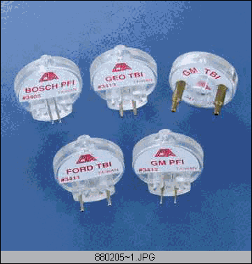

noid light is a light that has 2 prongs to fit into the harness at the injector plug. then when ya turn the motor over it sends a signal to the light to flash on the injection pulse. this way ,ya know if your getting power to the injectors. you need to test each plug on the harness where the injectors plug in at.

http://www.carburetion.com/images/noidlights.gif <~~ A picture of noid lights, you can google and find where to get them im sure.

Ok, so I got the noid light and tested all of them. No light up. What does that tell me?
