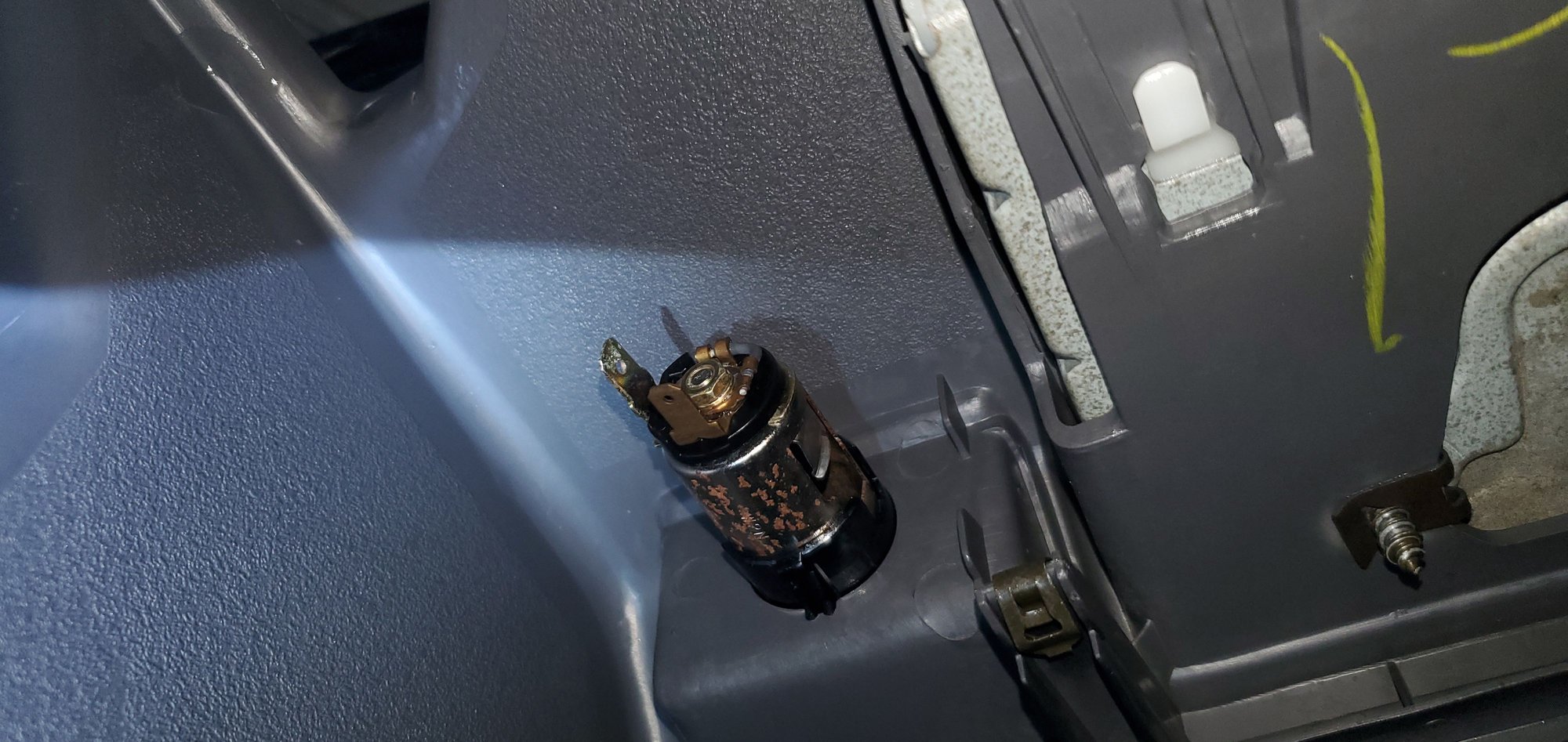

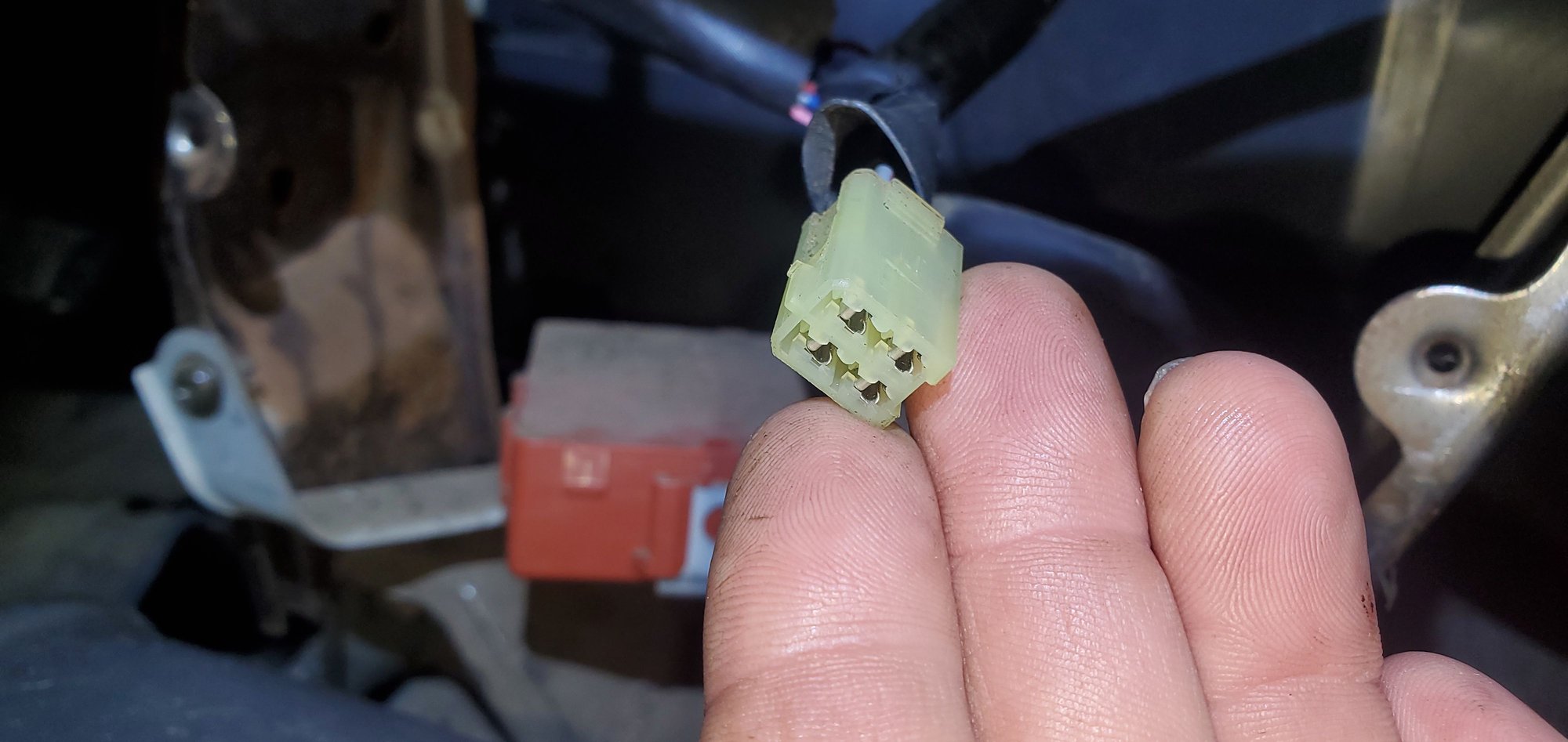

Ashtray harness on 1993 has no lighting wires and is different from the 1989 truck. Also pictured is a single wire plug that used to go to stock stereo. It seems to be a ground that changes voltage while using the dimmer switch, but i am guessing here.
Ashtray light harness on 1989 truck is 4 pin.

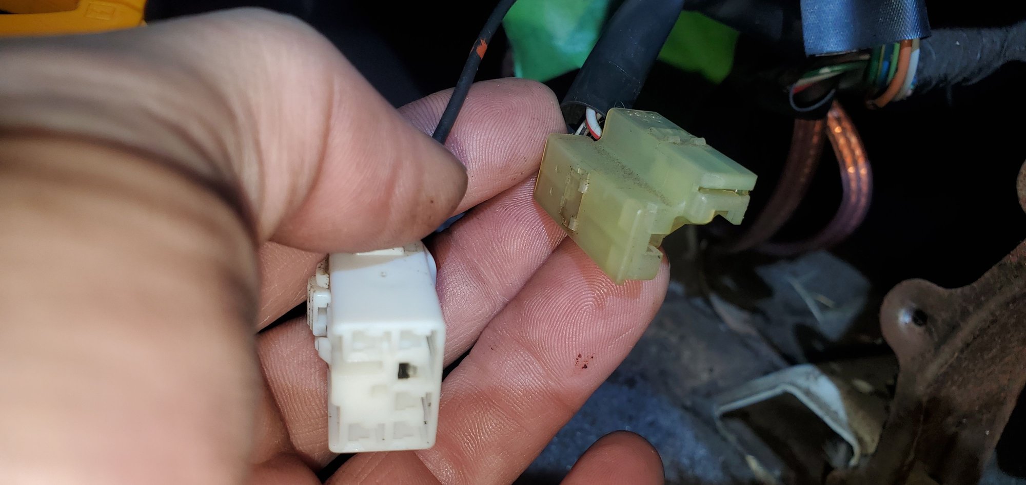

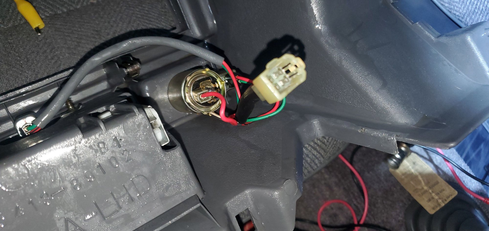

1993 ashtray and lighter in lower console.
1989 ashtray and lighter with lights.
