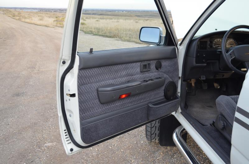

Which trucks came with map pocket door panels?
I have searched around and can't figure out exactly which trucks came with map pockets. Was it the SR5? Was it only 4Runners?
I have a 1994 DLX Xtra Cab and wanted to install door panels with map pockets in my truck, but was not sure if they are an exact fit or not. If they are, how common are they to find? The local junkyard never has them...
The ones I am referring to are pictured here:
Attached Thumbnails Which trucks came with map pockets?-dsc_0073.jpg   Which trucks came with map pockets?-dsc_0065.jpg

Is it "documented" somewhere which trucks came with the map pockets, and bucket seats + center console? That's what I was really asking...
i.e. did all SR5 models - both pickups and 4Runners - come with these options? Or did only some? Or did all SR5's and some DLX's? Or did no DLX's? Etc.

To be clear - I am asking about the entire door panel. The ones with cloth on them and map pockets on the bottom.
I was not asking about map pockets on the vinyl door panels. I have never seen this unless someone custom fit the map pockets onto the vinyl panels themselves.

I am thinking that you wont be able to use a 4 Runner door panel. A friend of mine tried to put an entire 4Runner door on his truck. It came off of a four door runner. The 4Runners door was 1/2 inch shorter then his truck door. You might could use a 2 door runners panels but that is going to be tough to find. This applies to the 89-95 trucks.

Terry's correct about the 4-door runner panels not fitting your 94 Xtracab, they will be too short. There are threads about this subject, but to sum it up you can use 89-95' truck door panels or 90' 2-door runner panels.
You asked about which trucks come with map pockets - I don't know which specific models come with them, but some do. And some don't have carpet on the pockets. I can say that almost all 89-95 runners come with them since I've yet to see one at the junkyard that didn't have them, and again the difference that i've seen is that some come with and some without the carpet on them.
I don't know what end result you're looking for, but if you want map pockets on your door panels then grab them from a 4runner and install them like Terry demonstrated. That is the same thing as finding door panels with them already installed and are much easier to find.
You showed a picture of cloth door panels with map pockets, if that's what you want then Yes, it is hard to find them at a junk yard, but not impossible and you may still need the map pockets from a 4runnner to get what you want. I eventually found some after a long while, but had to fully restore them myself. https://www.yotatech.com/forums/f116...panels-256546/

I am looking for the door panels that look just like the ones I pictured - not just with map pockets, but with cloth on them as well. I was under the assumption that all door panels with map pockets looked like that (with the cloth) which is why I titled this thread accordingly.
My windows are manual. I have yet to find a picture of those cloth covered, map pocket-equipped door panels with manual windows.
