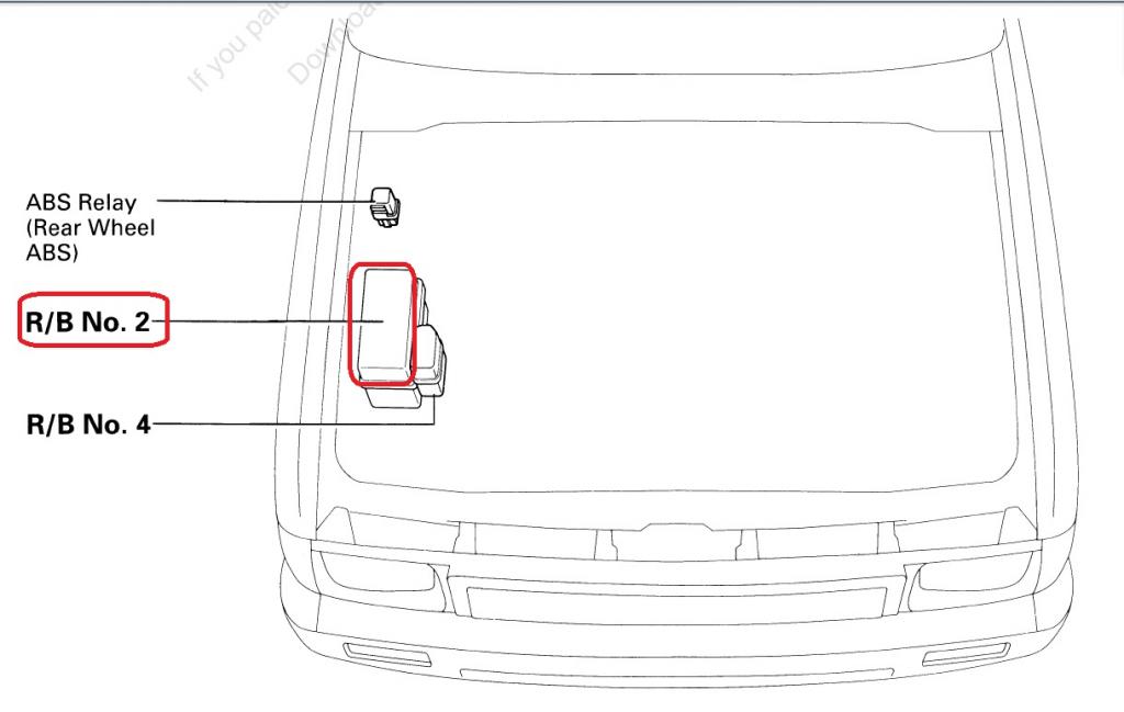

Need to find your starter relay. Could be in a relay block
here?
We could not be sure. You would have to find it yourself, because you're the one who can hear and feel the click.
Once you let us know what you find out, we'll go from there.
