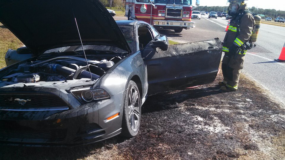

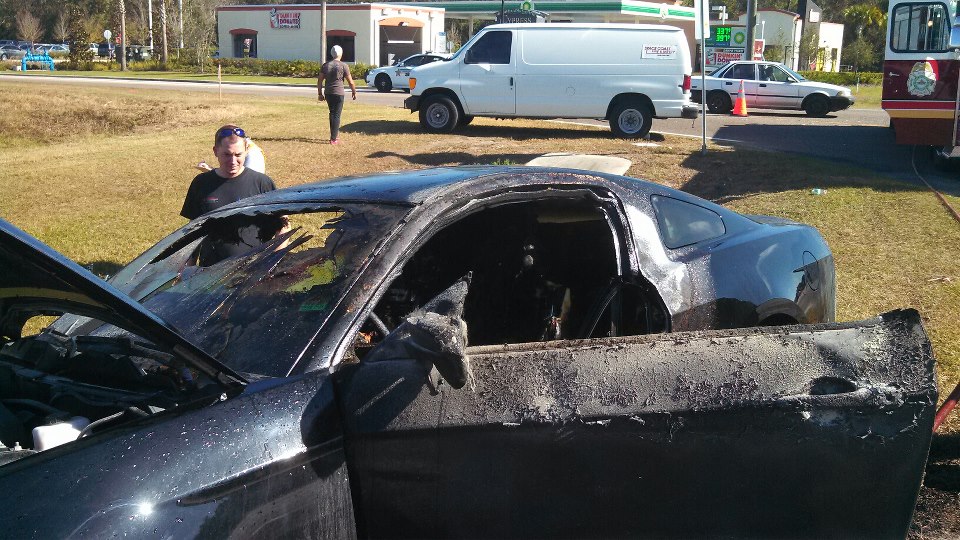

But I am now the proud owner of a 1990 Toyota pickup that will be better than that mustang ever could have been... and none the less more reliable hahaha

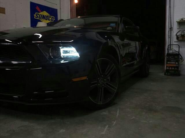

in her prime

Wow! What the hell caused that?
Old Oct 6, 2013 | 11:10 AM
  #34
cferrera3's Avatar
Joined: Oct 2013
Posts: 32
Long story short, I had wired a nitrous kit with a 0 gauge wire and than had a fuse block than another fuse block/splitter and ran the kit from the splitter. with room for expansion. Well where I had my stereo installed, they thought well I will just tap into the 0 gauge with a 2 gauge, wrap it around and tape it. Well needless to say it caught the back seat on fire in the trunk where the amps were at. They didn't do like I told them to so now I am that much richer lmao. But no one was hurt and insurance covered the damage. I am much happier with my older truck TBH. I can fix everything myself and improve what I want for how much I spent on that car.
