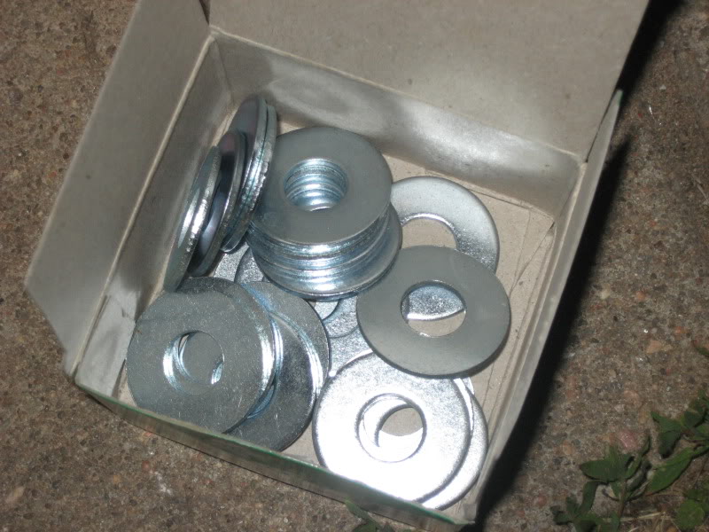

I was thining about a stack of washers?

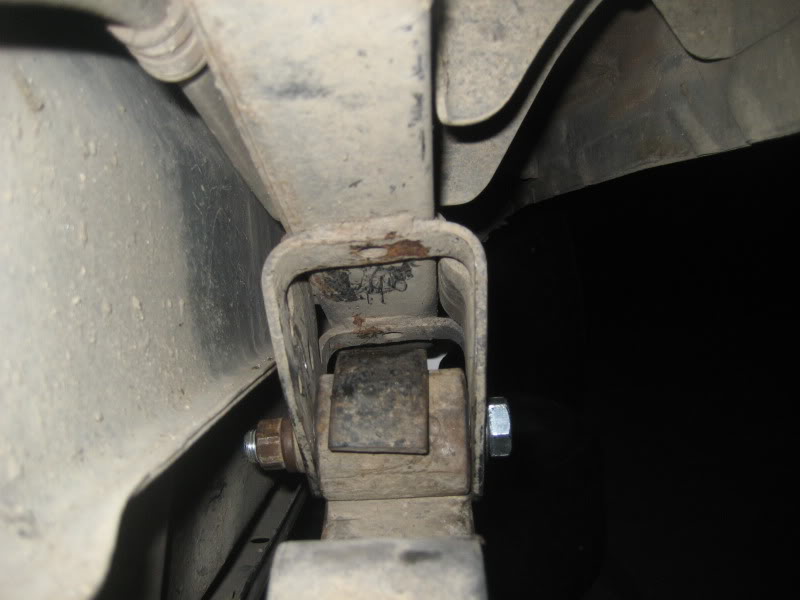

Here is the result with the washers, drives just like before but I had to pinch the hangar a bit as you can see in the last photo.
washers don't flex like poly or rubber. just wait for the bushing and save yourself a broken or bent spring or mount.
Old May 22, 2009 | 08:45 AM
  #24
Kiroshu's Avatar
Joined: Oct 2007
Posts: 2,747
From: NC
not a good idea but can best a fix untill you get bushing because for one all those washers will rust together causing more probs than before and they won't hold long....
Old May 22, 2009 | 08:46 AM
  #25
4banginRunner's Avatar
Joined: Dec 2005
Posts: 2,024
Likes: 6
From: Souderton, PA
WTF are you doing?

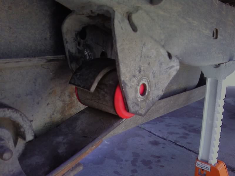

All is fine now

Very sexay! And much safer.
Did you get the greaseable bolts to fit in there as well?
