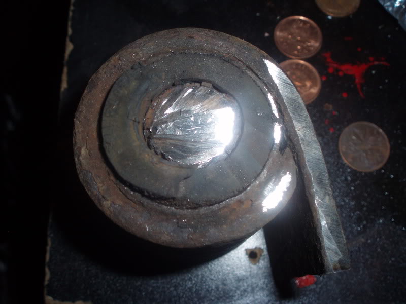

I was taking on what should have been a simple task, installing smittybuilt steps on the side of truck. The trouble came when I went to remove the bolt on the forward mount of the leaf spring, it came loose from the bracket but not from the bushing. I put a breker bar and pipe extension on it and it turned almost half a rotation but wouldn't come loose from the bushing. The bushing would give a bit but the bolt had seized to the metal inside the bushing.
To solve this I cut the bolt and torched out the bushing, not too hard but now I can't find a replacement bushing. Everywhere I have checked only has the rear shackle bushings. Any ideas?
Here are a few pics.

What the bolt had seized to

You are also going to have to press the outer metal sleeve of the bushing out. That bushing consists of the outer metal sleeve, rubber, and inner sleeve. In your picture, the bushing is not fully out. The same thing happened to my leaf spring. I had to cut the bolts and use a ball joint press to get the bushing out whole. It was a real PITA

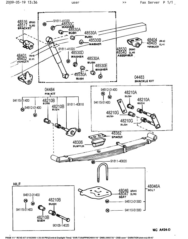

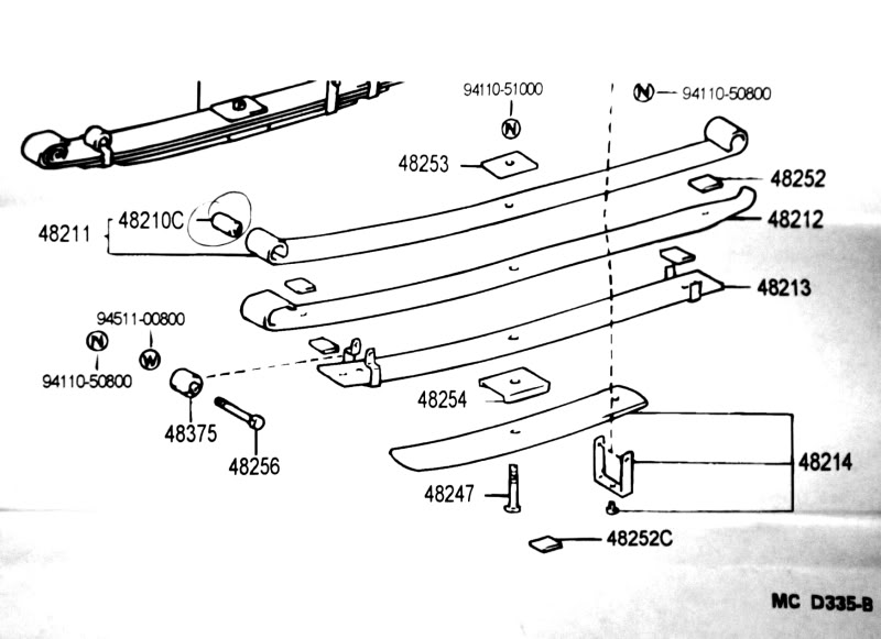

Which part # would you call the bushing on these diagrams my local toyota dealer faxed me?

48210C in the lower diagram. Upper picture is for the earlier pickups with the funky spring hanger pin.

Originally Posted by trbolvr
Sure its not 48210C?
Actually that may be it, hard to tell in the parts diagram.
