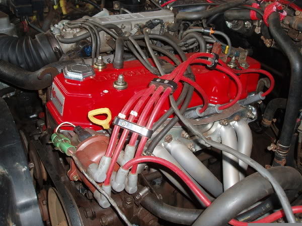

DT tri-y pricey but it performs well 2 1/4" pipe with a Borla SS muffler Name:  tri-yinstalled.jpg
