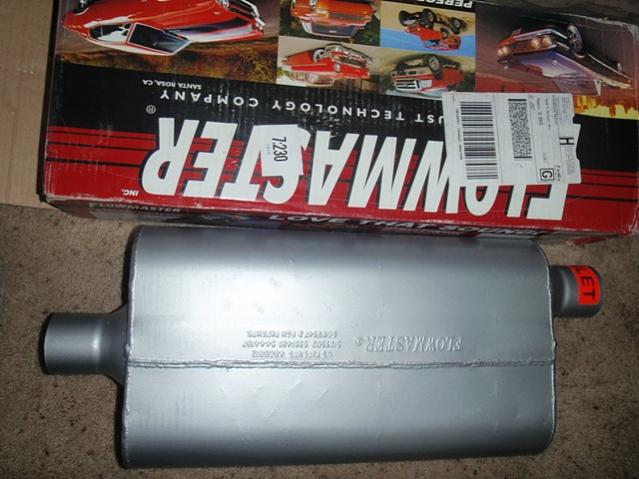

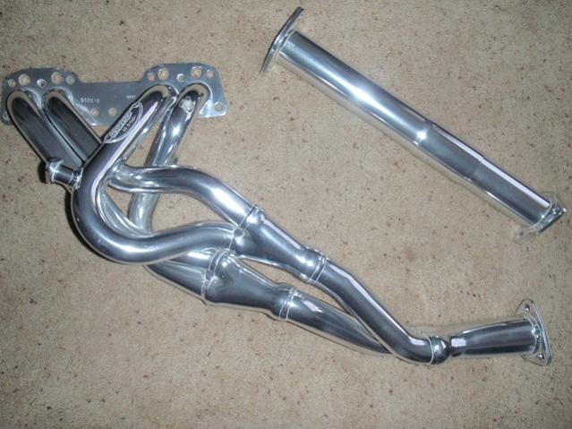

im running the dt headers magniflow hi flow cat and a flowmaster 50 series 2 1/4 all the way back and there is a deffinatly a good low end torque increase for shure espeshally with my LC cold air intake i really like it allot ive had pace setters and headman and the doug thourlys are more expensive but well worth it for shure

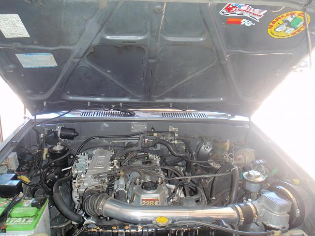

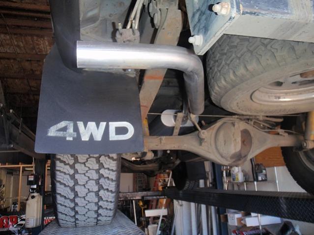

heres some pics of when i first did it the only thing about the doug thourlys i didnt like was how they kinda point at a downward angle towards the bottom but with my pipe bender it wasnt a big deal and i havent had any problems at all with them and i havent hurd anyone else who has so im curious what uve been hearing hope this helps
