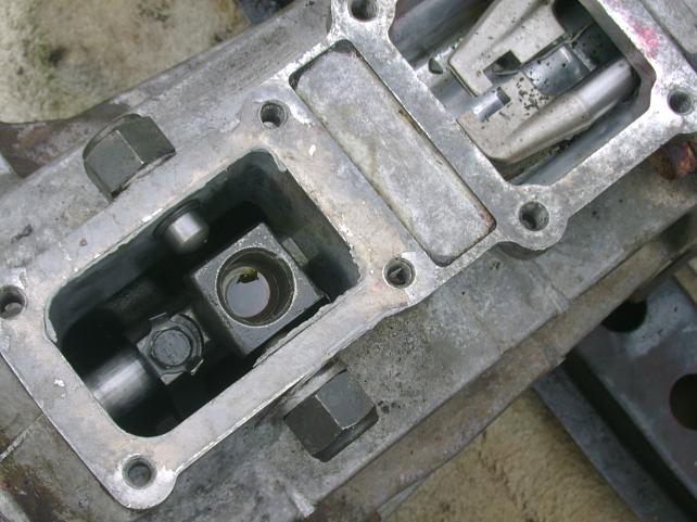

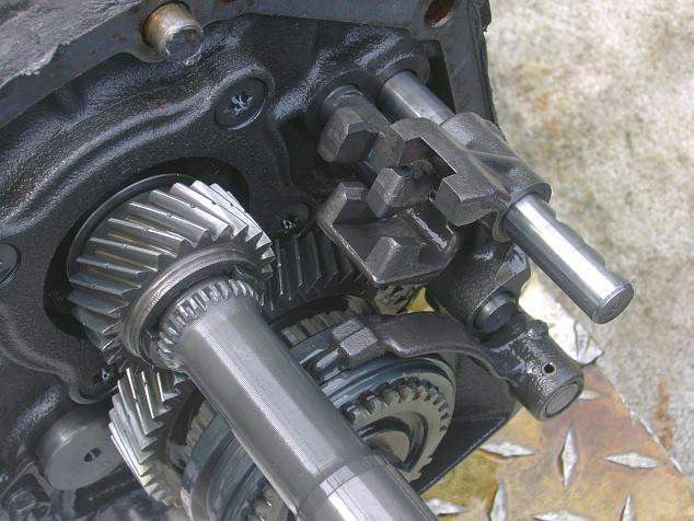

I have an 87 truck, extra cab, 5-speed, 22r, 280,000 miles and am having frustrating transmission problems. This is about the 6th or 7th time i have had to bring it down. The PROBLEM you ask? It always gets STUCK!! Twice in my own driveway and once in a gas station a mile from my home (the other times it was stuck was when my brother drove it). The last time it was jammed which was about a month ago wasn't so bad because it was stuck in 4th gear and i could still drive home like that. I drove around like that for about a week until i smelled smoke: the clutch maybe?? So i took it down yesterday got it unstuck an am afraid to put it together just to get stuck again. I also noticed something that to me didn't seem right: two different gears (4th and 5th i think) could engage at the same time. I thought maybe it was missing a snap ring somewhere but didn't find anything in the manual. Also about a year or more before that i replaced a gear and syncronizers from toyota because 4th was making a grinding noise.
I attached some pictures of it, the gears, and forks, So if anyone has been down this road please help as i am trying to get her done before i head back to high school in september, and if that wasn't enough i have a horrible timing chain cover leak( about a quart of oil a week).

Sounds like a shift fork or hub sleeve that has a lot of wear and play, allowing the sleeve to stay between the two gear hub splines. I'd change the worn parts before something breaks (like a gear) and it gets more expensive. Good luck and let us know what you find out.

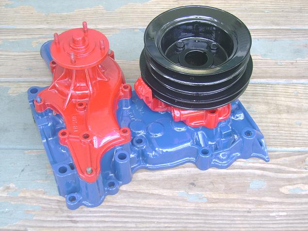

As for the timing cover, it was also done before school. I used all new fel-pro gaskets from autozone( $8 kit)with permatex gasket sealer and siliconed the top to the head gasket. ZERO-leaks.
While i was there i repainted the timing cover blue, touched up the oil and water pump, black pulleys, and red a/c bracket. Looks cool/Nice n clean.
I took pictures and will be posting those later.
