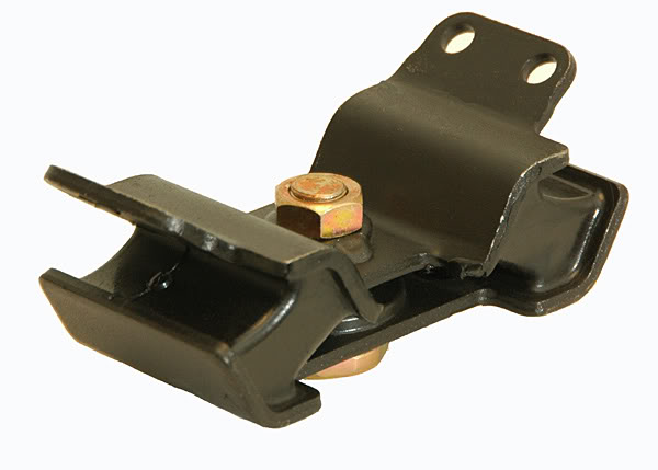

t-g stock mount:

my transmission actually has no mounts--they are on the engine and transfercase (x2)..
