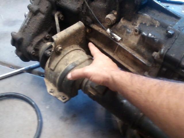

They fill seperately. You can over fill it or under fill by going thru the top. Fill from the side until it comes out the fill hole.
I cant see the front shaft dust cover making the bolts bottom out but it possible.

Thanks, Terry's 87. On the second question, I'm actually talking about the (6) bolts that bolt the transfer case onto the back of the transmission, so right above your forearm on that pic. For some reason, two of the bolts are longer, and I'm betting on some sort of bracket.
