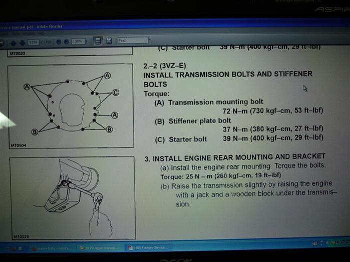

The FSM shows 12 bolts total, including the starter. Take the rear cross member and rear trans mount off per the FSM and lower the engine on a jack. This will give you plenty of room.

I just took off the 12 bolts and dropped the x member, i didnt take off the rear mount. It worked out fine.
