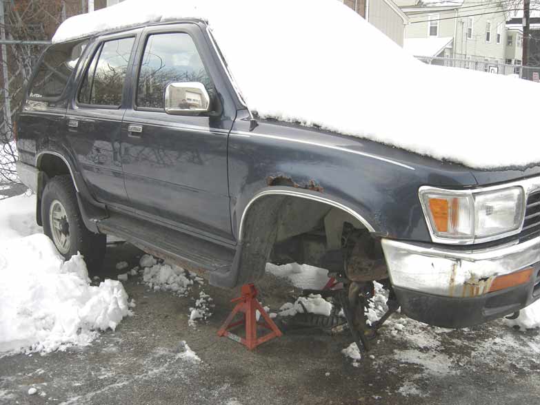

A few pics.
Attached Thumbnails Total Front Suspension Refresh-truck.jpg   Total Front Suspension Refresh-arm.jpg   Total Front Suspension Refresh-arm-2.jpg

Front suspension - NORMAL wear items are ball joints & idler arm on these trucks. Look at replacing those "while you're down there." Also have a look at your tie rod ends, & other parts too.

Before you pour more money into it...
FRAME Rot?
Major body rot?
Those two make the project a non daily driver resto project...

so if the front suspension is that bad, how bad is the frame?

You know, if I hadn't already done the windshield and the gate, I would have just bought my friend a beer and said thanks but no thanks. there is honestly nothing really good about this truck save for new tires. The interior is as beat as the outside, and so on.
the frame is surprisingly very good. the factory black paint/coating on the frame is intact for the most part with little minor rust. I'll replace the front fenders and bumpers, don't need the running boards and will have to weld in new rear quarters (or some portion of the sheetmetal) as well as rear bottom sheetmetal at the rear doors. If a West Coast or southern yard will cut the sheetmetal for me, I should be able to get it all in over a weekend.
if the engine checks out, I could see painting it in June or so. Given straight panels, I should be able to get away with just hitting it with 400/220, a cheap high build primer, quick sand and then a single stage coat, color TBD.
