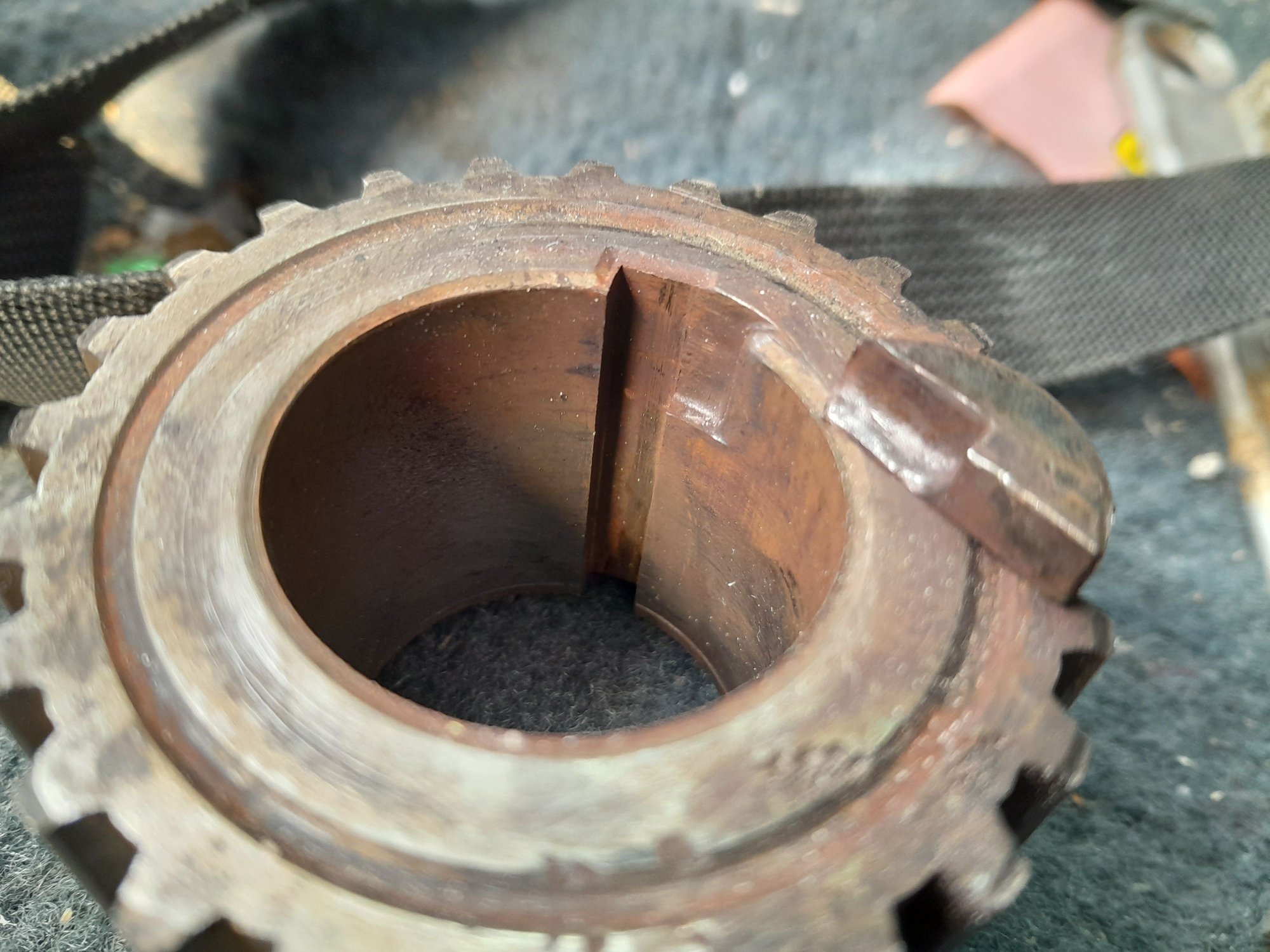

Finally got around to checking a few things. Rotor barely moves so teeth on dist are good, rotor however moves quite a bit on the shaft. When the rotor is installed I can move it several degrees either way. Cant see the balancer without pulling the radiator. Took the plug wires off one by one and all 6 are firing. Idle is smooth at 850rpm in park and 600 in gear. No idle bounce but has a slight miss is felt in gear. Ill try the tps reset mentioned above. Thanks for the replies!
bob
Old May 4, 2023 | 02:30 PM
Hound Dawg's Avatar
5 Year Member
Joined: Apr 2021
Posts: 61
Likes: 15
Never knew the condition of the timing belt, And I bought the aisin kit w idler, tensioner, and water pump. Took it to a shop to have it done, look at the crank gear n key it was about to go. Wow truck has some nuts now! lol
