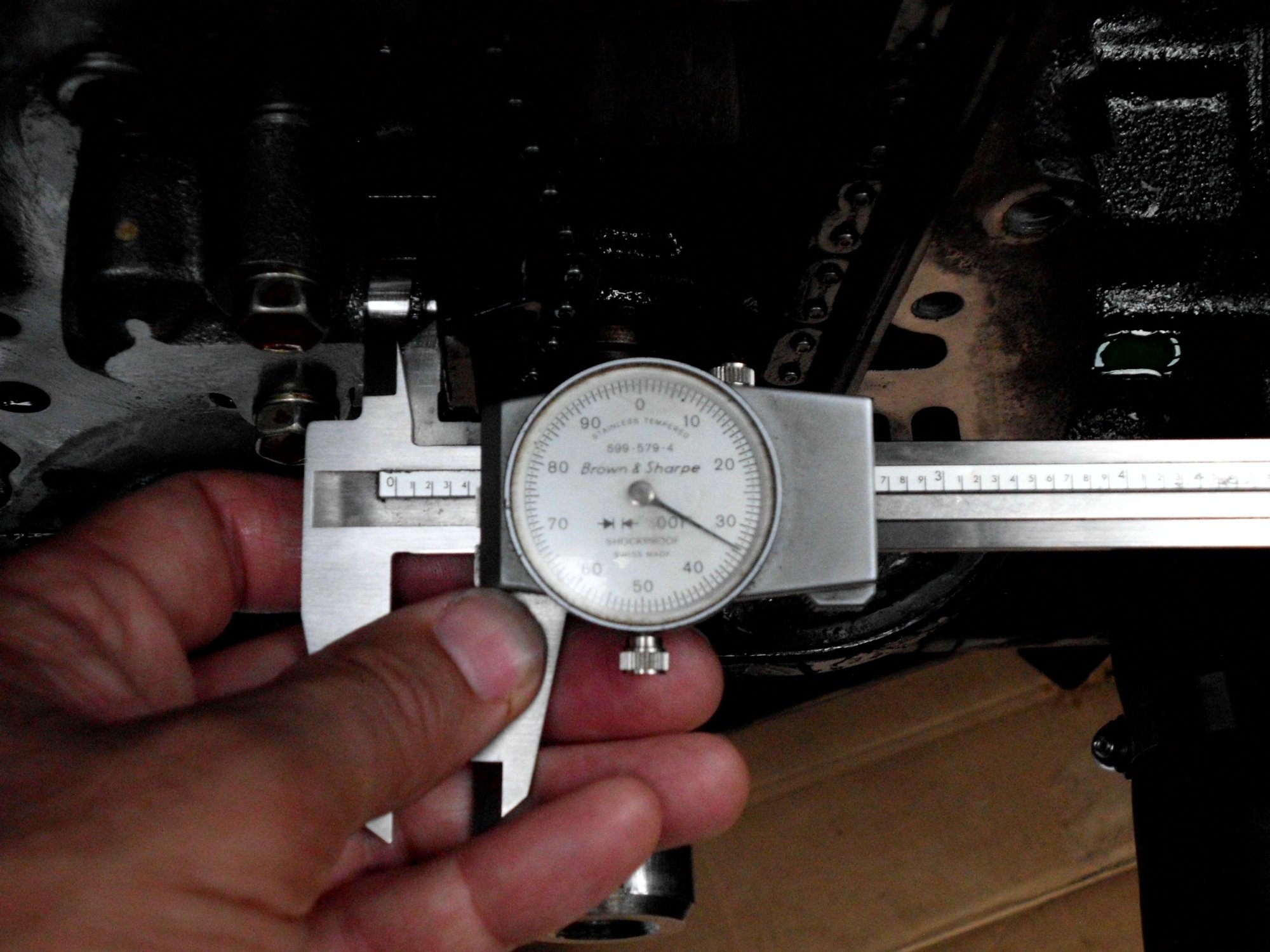

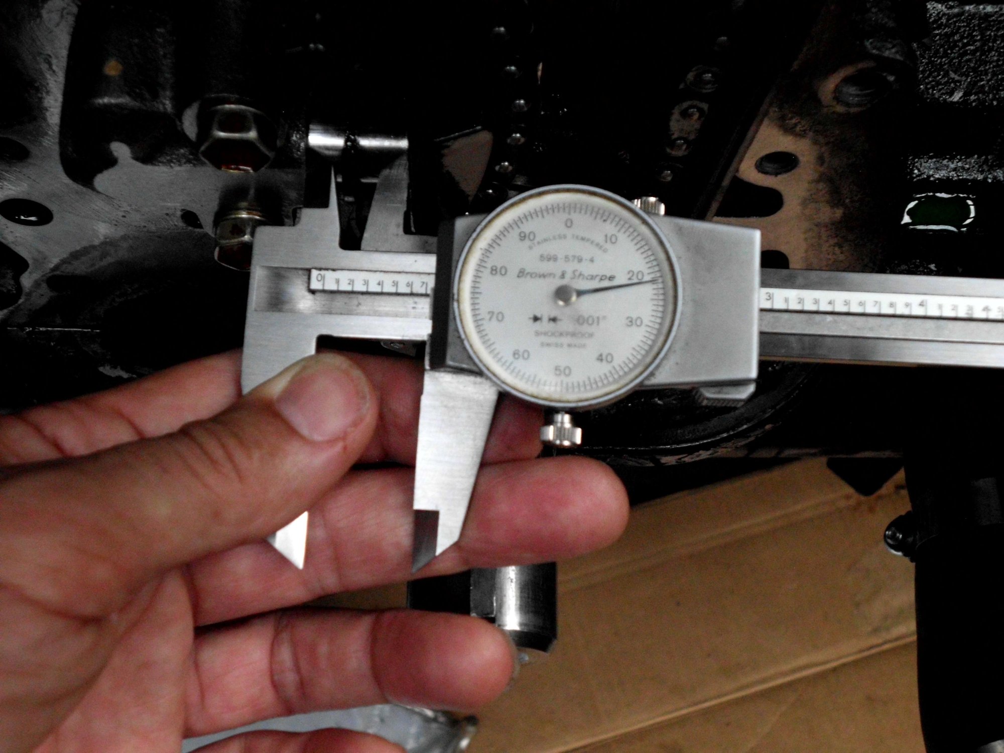

IF YOU LOOK AT THE PICS OF THE NEW CHAIN AND SPROCKETS WITH THE NEW TENSIONER AND HOW FAR OUT THE TENSIONER (.722 of an inch) IS COMPARED TO THE OLD TIMING GEARS AND CHAIN SET WITH THE SAME TENSIONER YOU WILL SEE THAT THE DISTANCE FOR THE TENSIONER IS ABOUT .20 inches.... max extension between the tensioner cylinder that extends and the tensioner pad the rubs against the chaini is about 1 inch... so with the new kit you only have 1/4 of an inch travel left on the chain tensioner... with the old oem timing set the distance it .432 of an inch so you have about 1/2 inch travel with the old componenets and new tensioner compared to 1/4 of an inch travel.with the new components and the new tensioner..whats up with that? something don't seem right here. With the the old gear set and chain the tensioner doesn't have to stick out as far as this new chain and sprocket set.. I will try to test the distances between the old timing gear and chain along with the new one with the oem tensioner in place.... I have heard of peoples who had trouble with aftermarket tensioners where they dont really take measurements and just go get an oem tensioner... but after ciewing the distance of travel I am thinking of sticking with the old chain and sprocket set and just keep the metal guide in place that I got from DOA... this is depressing to have to go back and fix when it wasn't making noise and I thought I was upgrading what I had.... will try and keep you all posted... hope it helps someone.
note there is already some suspicious wear on the new timing chain and everything was set in to place and run for about 2 days and 20 miles at various speeds. pics included if I can get them up on this thread.
new chain and sprockets and distance between tesioner and back of tensioner pad is .722 of an inch
old chain and sprockets and distance between tensioner and back of tensioner pad is .432

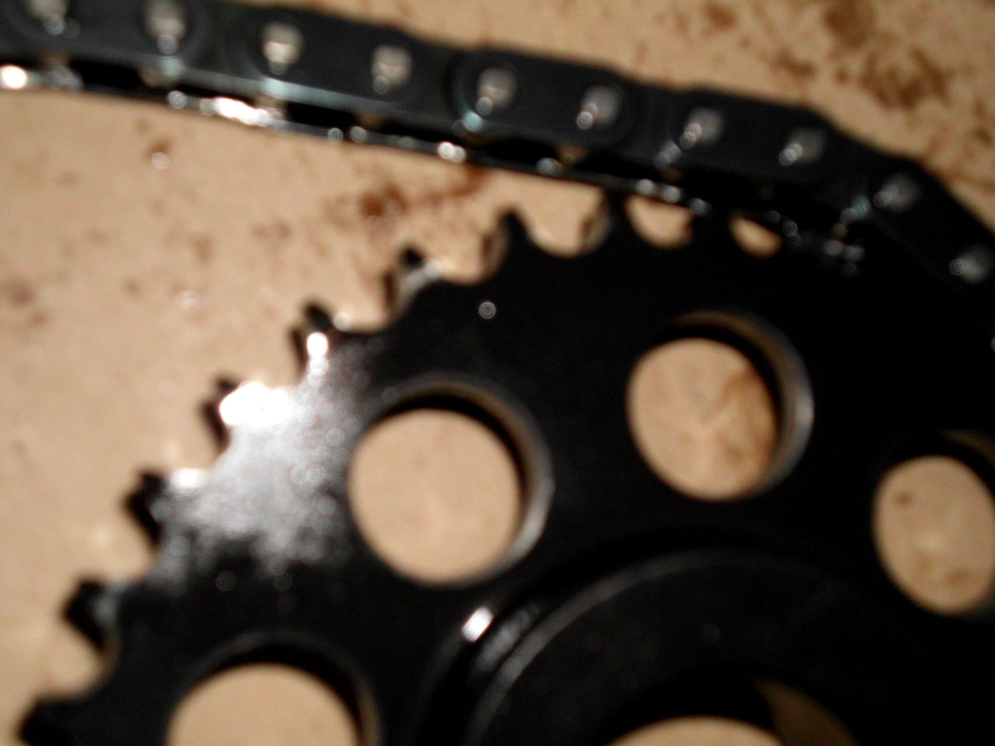

new chain and sprocket and if you look at the shiny marks on the inside of the links and on the edges of the sprocket these are wear marks.
