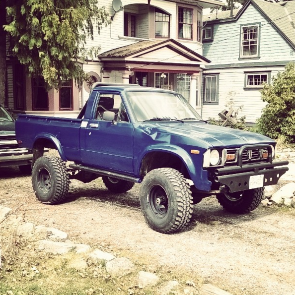

I have a '81/'82 4WD Toyota Pickup (Gas). The engine and some other parts are from an '82. I am by no means a mechanic, but I've owned this truck for over 10 years now and have done a lot of work on it. This is the first time I've haven't been able to fix something. Any advice or suggestions on this would be appreciated.
