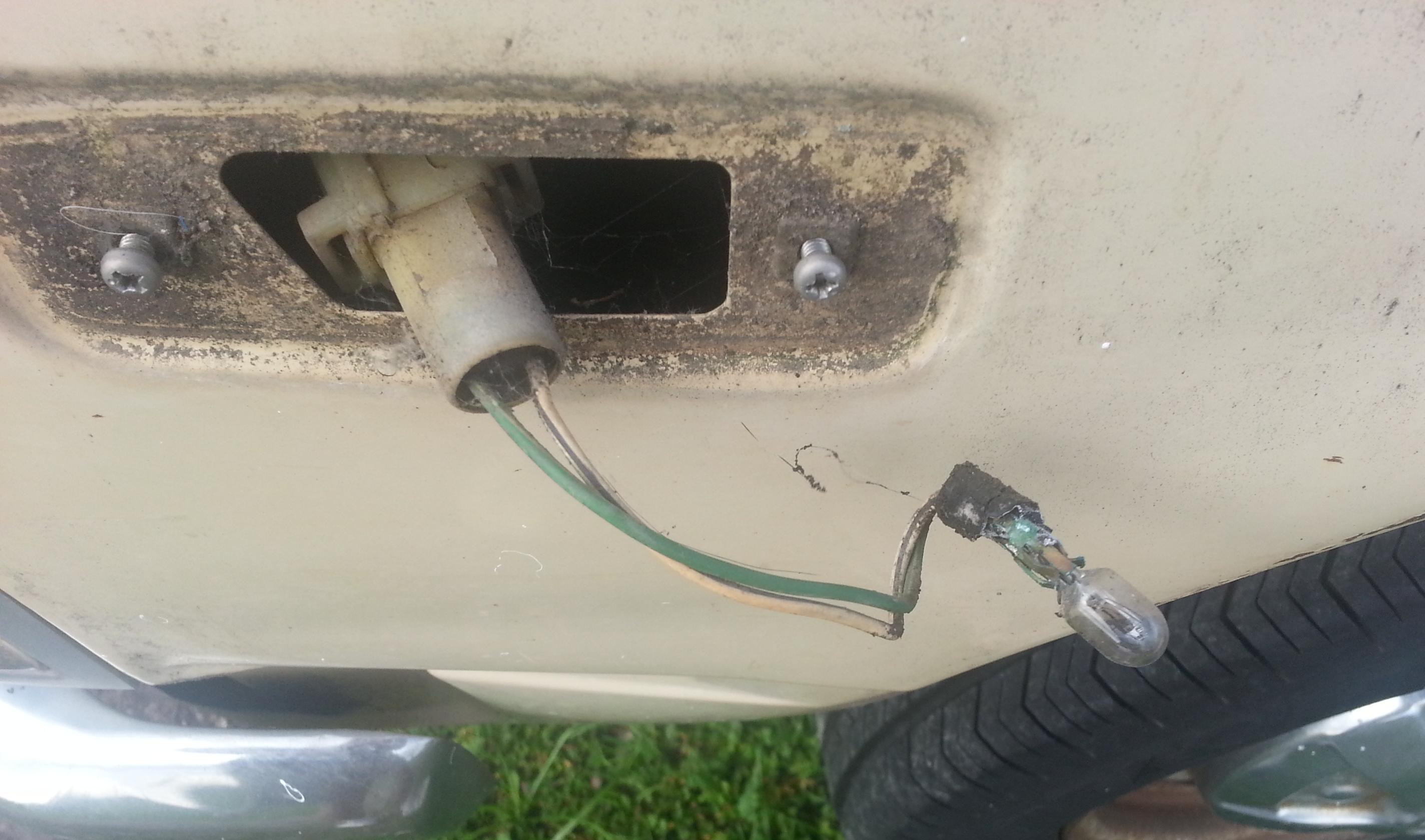

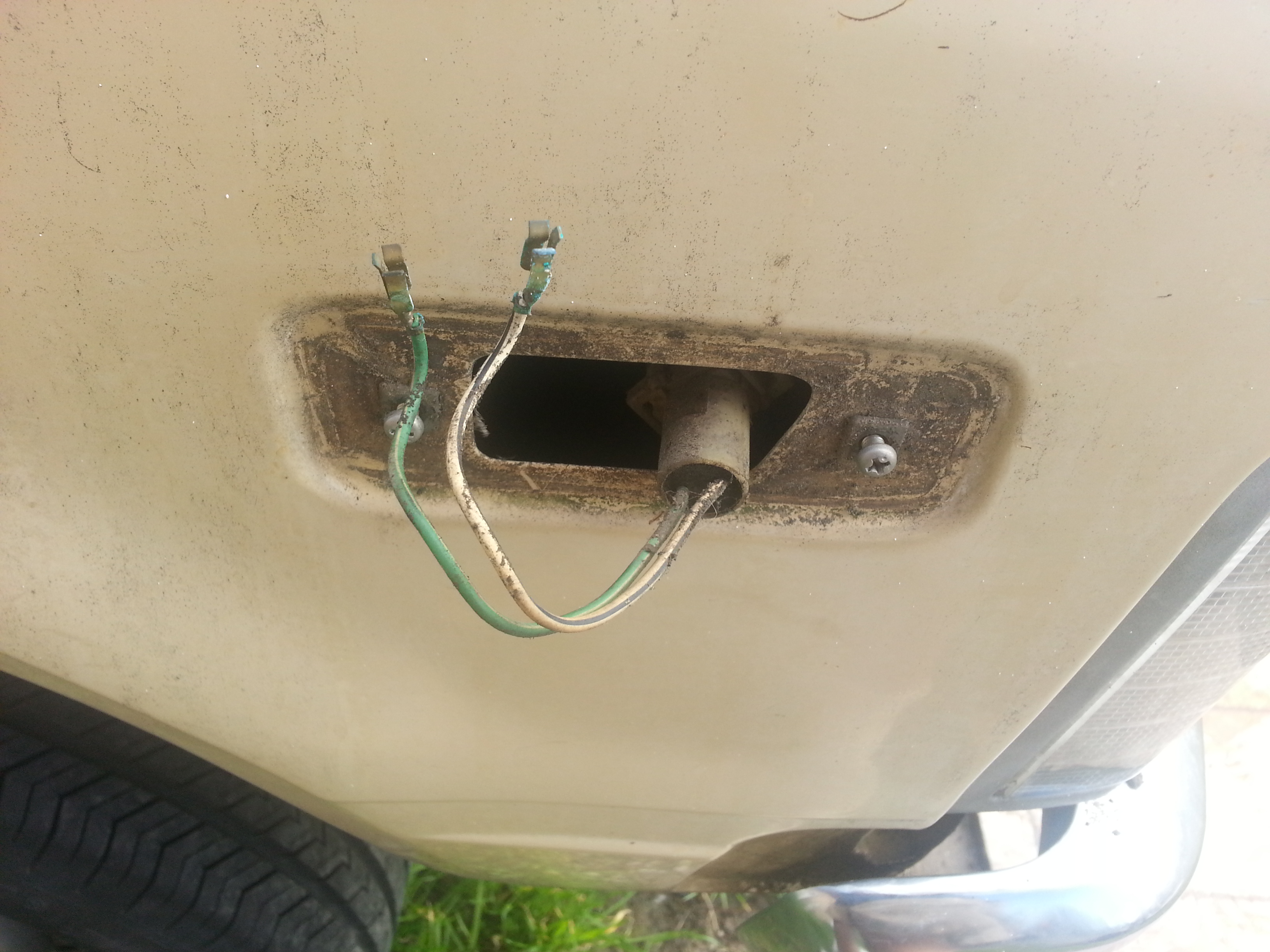

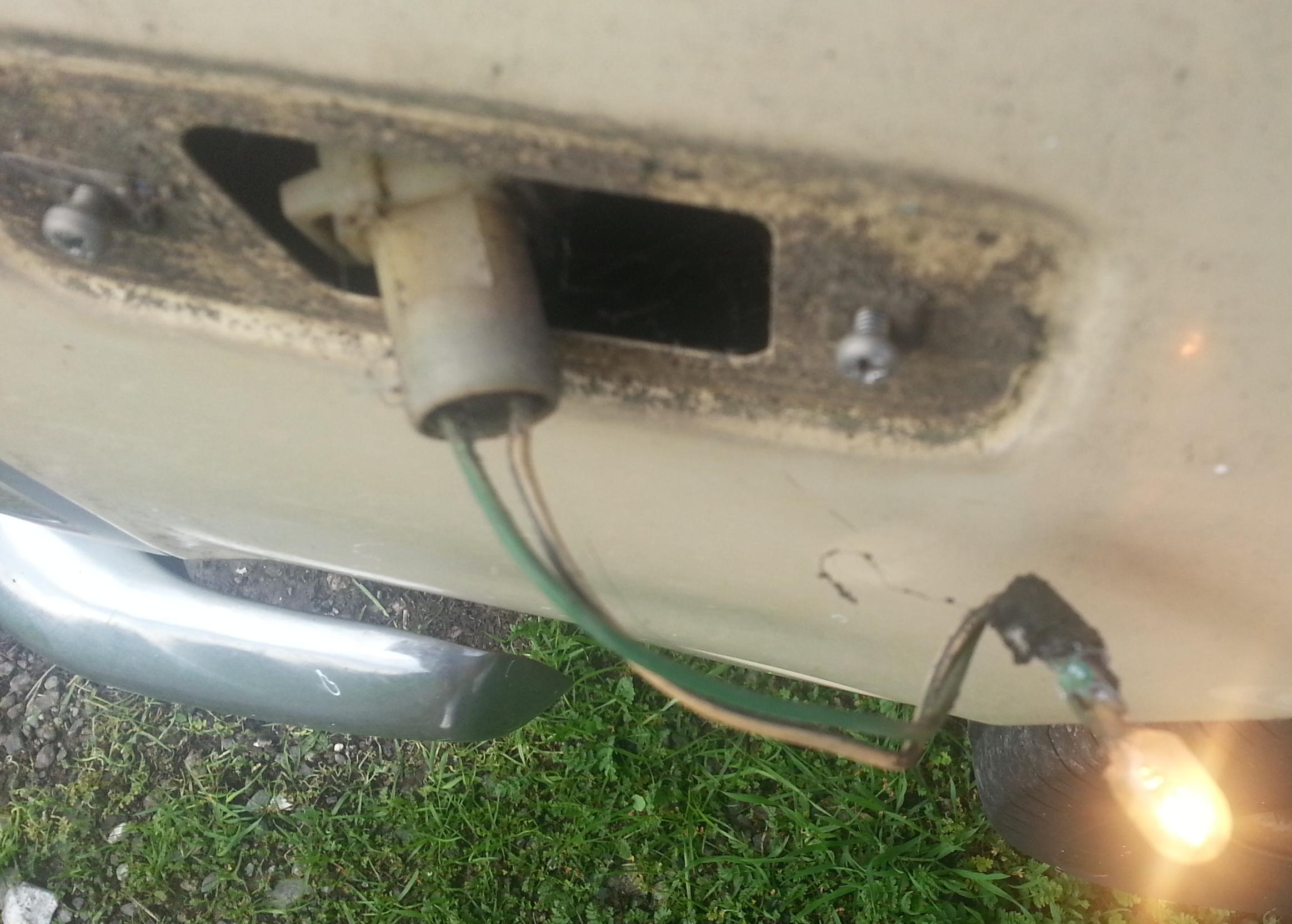

The fender lights on my 1981 pickup weren't working. As I am attempting to do a full restoration, I needed to fix that! When I pulled the orange lens off to see where the light was, all of the plastic under it crumbled. I found the light hanging down in the fender.
This is what was left of the drivers side:

And it still works (it was shining under the vehicle):

This is what was left of the passenger side:

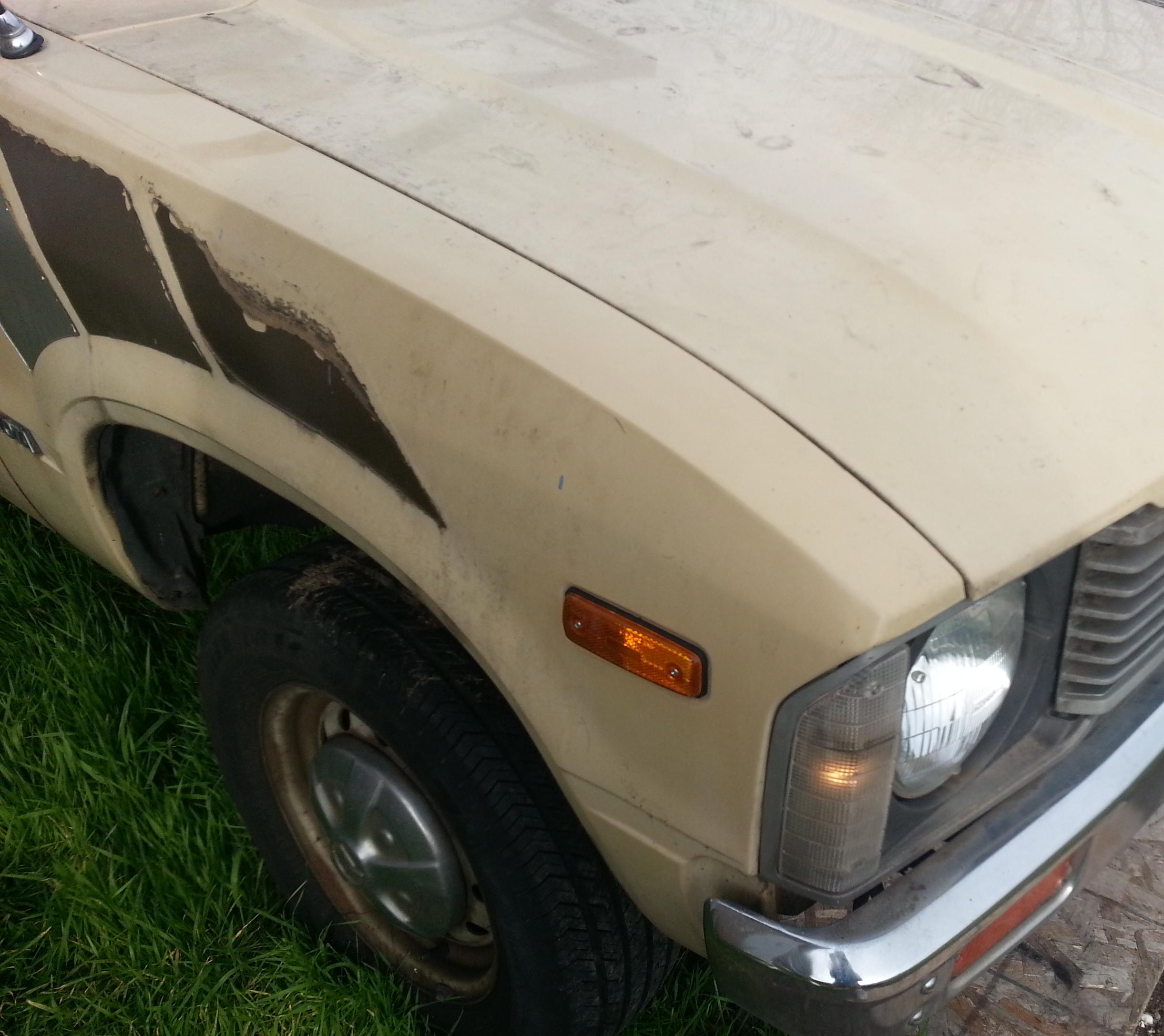

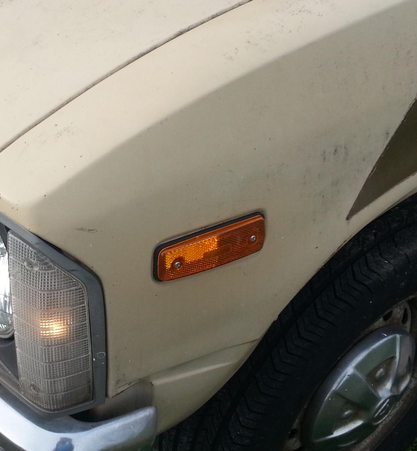

Here are pictures of them on the truck:

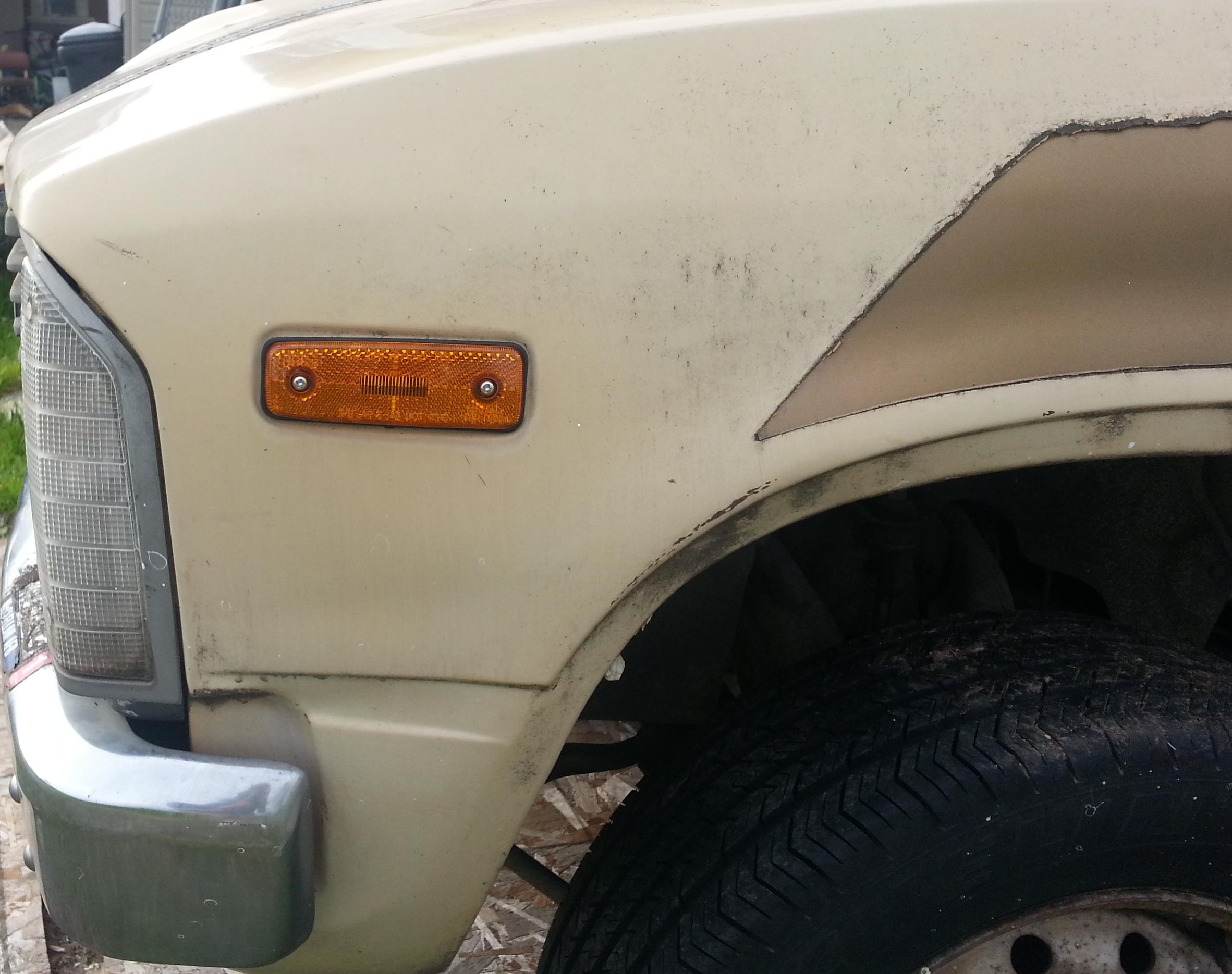

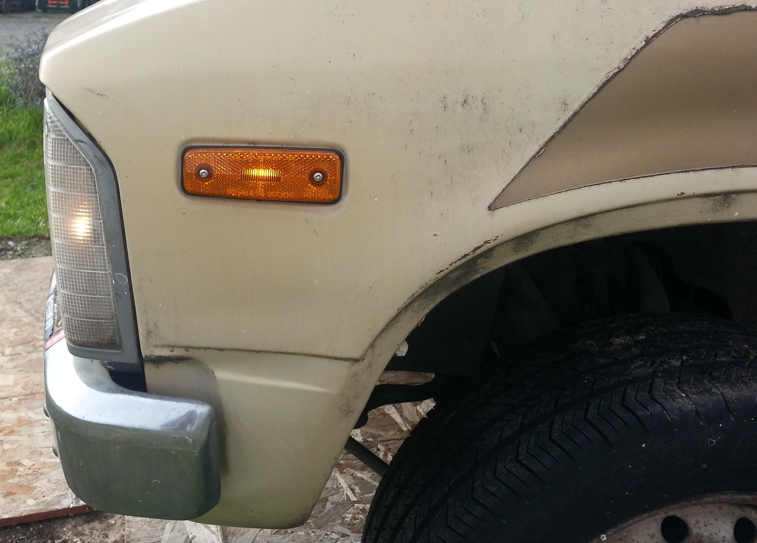

Driver Side:

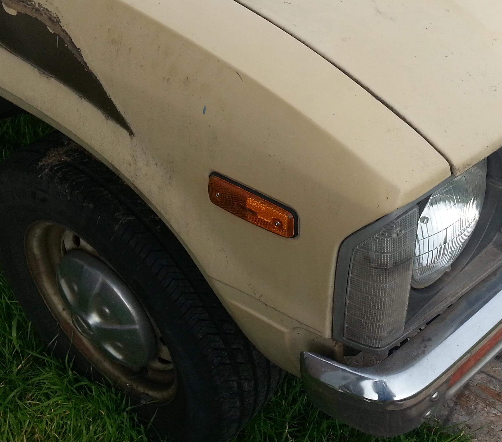

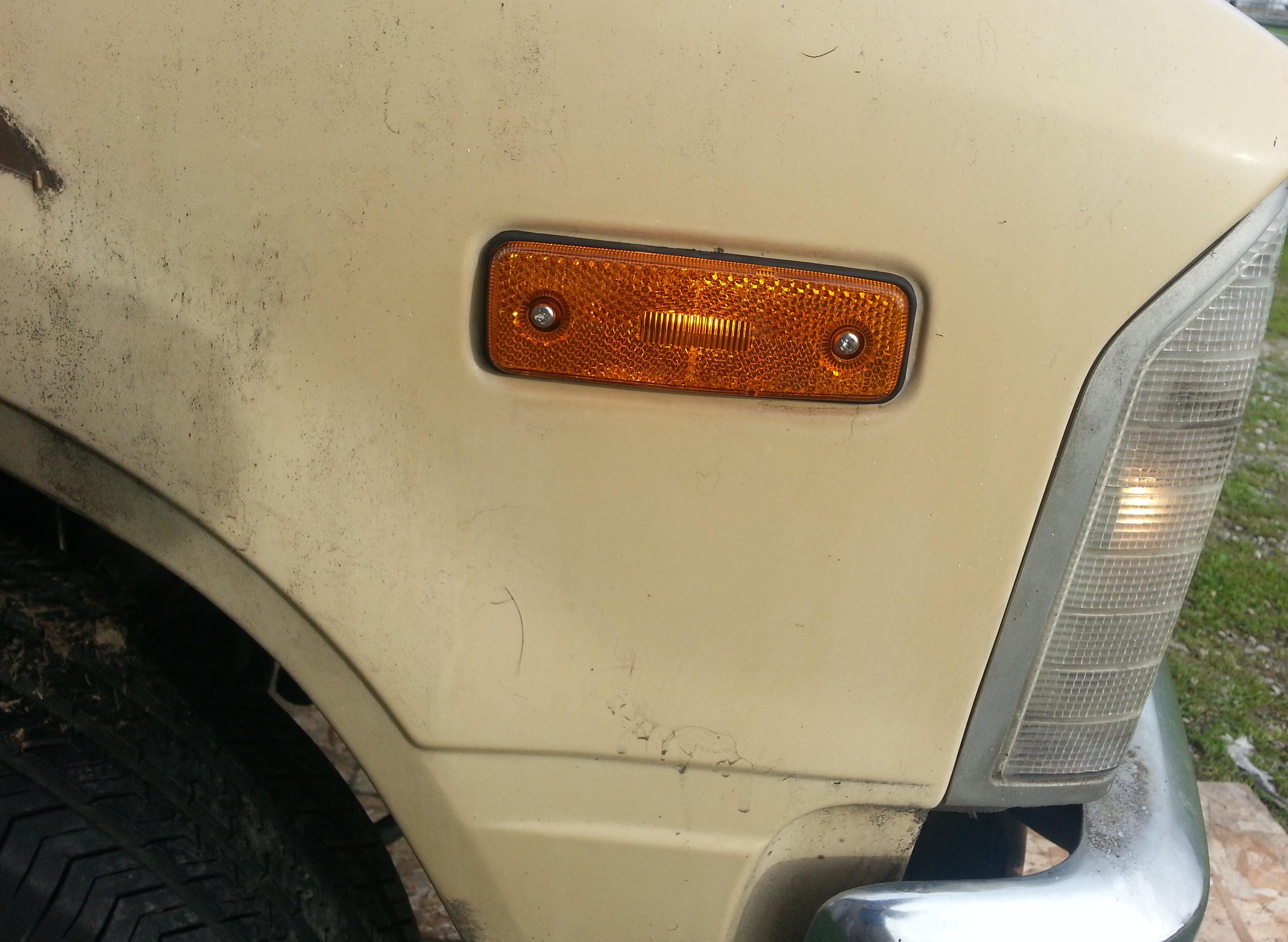

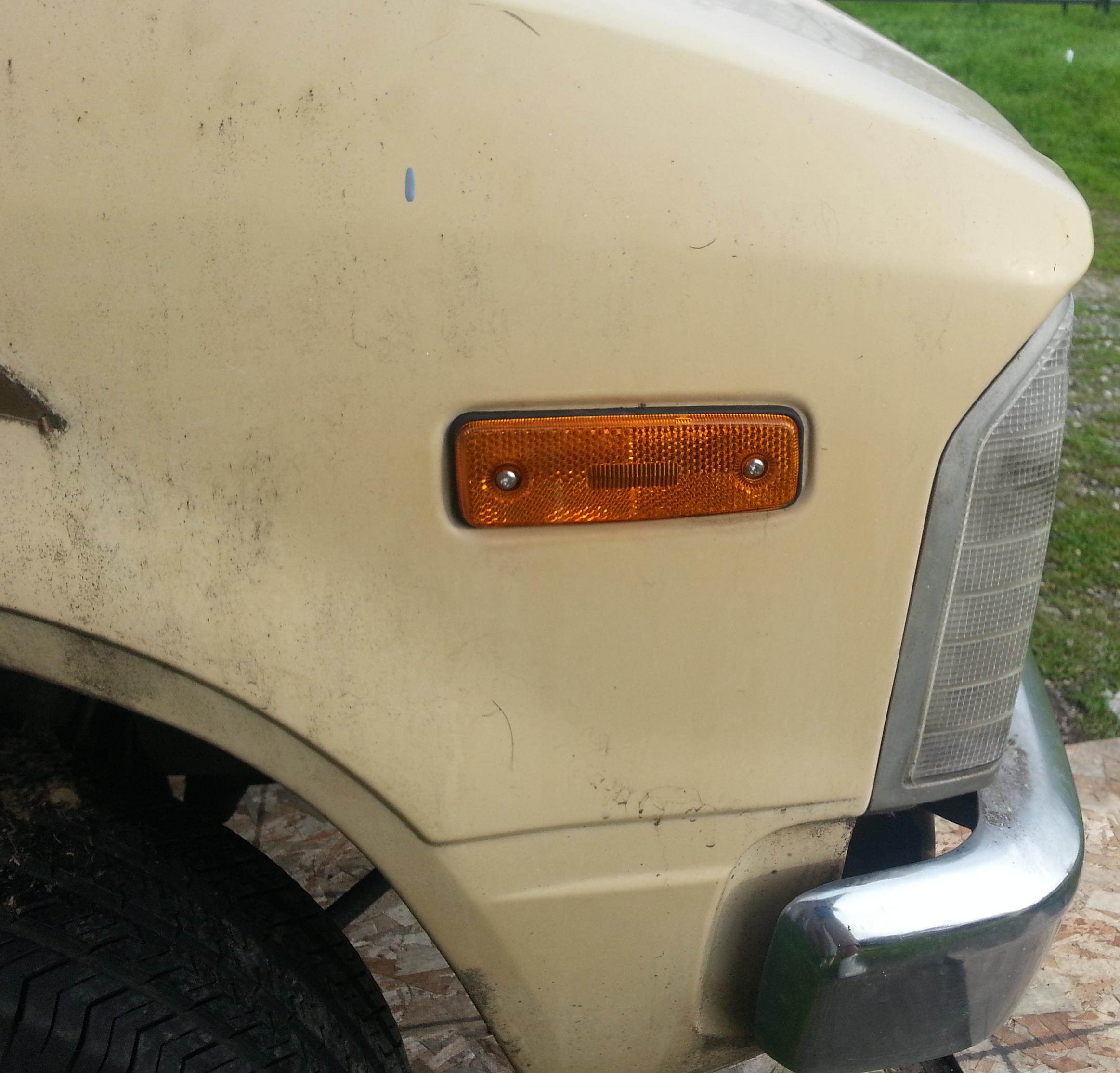

Passenger Side:
There have been a few light rains since they were installed and so far the lights have kept working. So far they appear to be fine. Shine brightly at night (enough that you can see them shine on a wall 3-4 feet away). Screwed right in where the old ones were.
One step closer to getting the truck restored!
