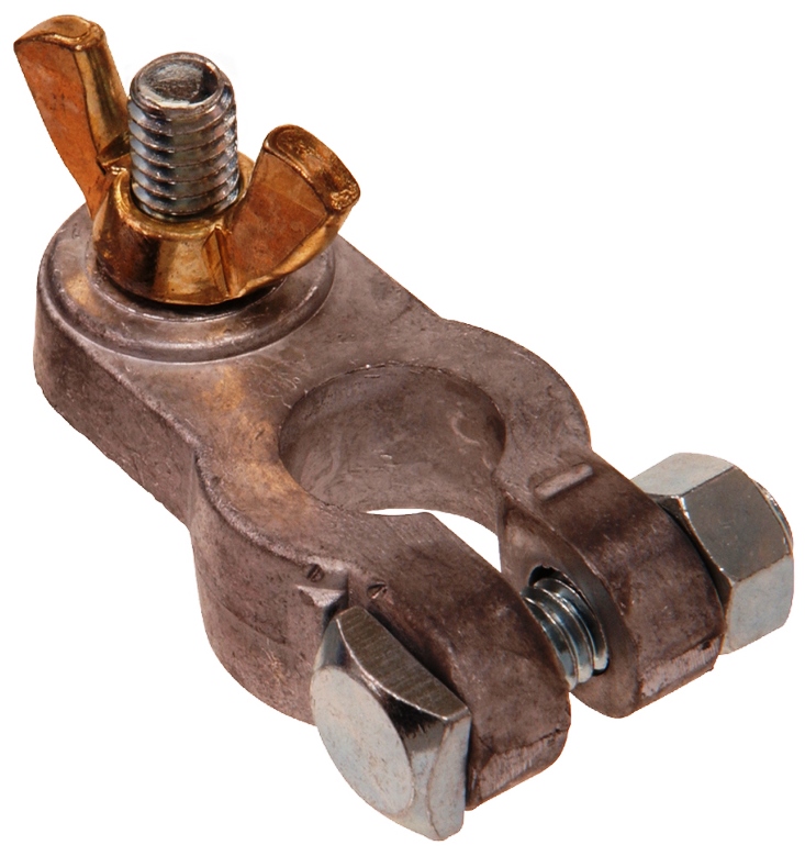

When my engine got rebuilt, shop that does a pretty clean job replaced my terminals with marine type like this. The terminal seems robust and easy to clean. The potential weak point point now is interface of battery cable and ring terminal crimped on to it.

Those are cheap emergency terminals the ones with the two bolts meant to get you home .
I use nothing but the marine type terminals .
Then having all the goodies to crimp on lugs it makes it easier to remove and crimp new ends on as needed

Originally Posted by wyoming9
Those are cheap emergency terminals the ones with the two bolts meant to get you home.
These are the ones that Mark has, correct?
That is the one on the negative post. I guess Nolo contendere. It is what I had to work with for the time being. Maybe I changed it from OEM, but if I did I must have dis-remembered. However, it did get me home, even without Ruby shoes.
