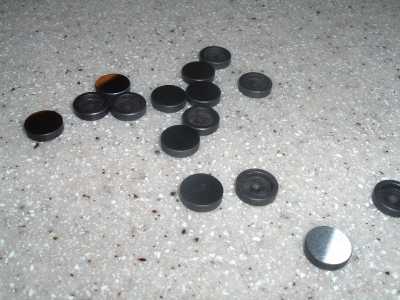

Old Aug 4, 2012 | 03:23 PM
BirdDogg's Avatar
Joined: Jul 2012
Posts: 44
From: San Diego
Here are my custom "bucket tappets" or lash caps
