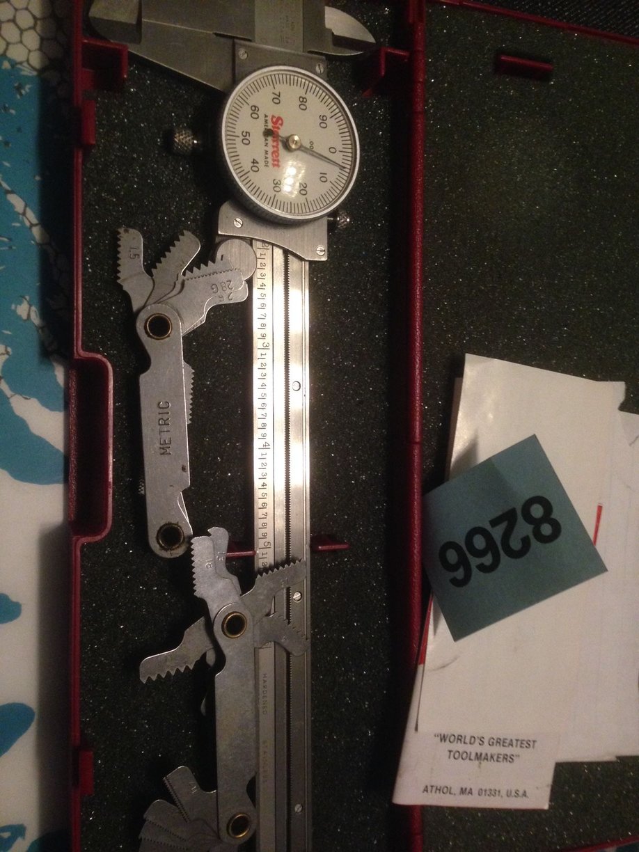

Thread gauges are readily available at Lowes and Home Depot and Sears
They come as "standard" (i.e. SAE) and "metric"
But perhaps I misunderstood the question.
