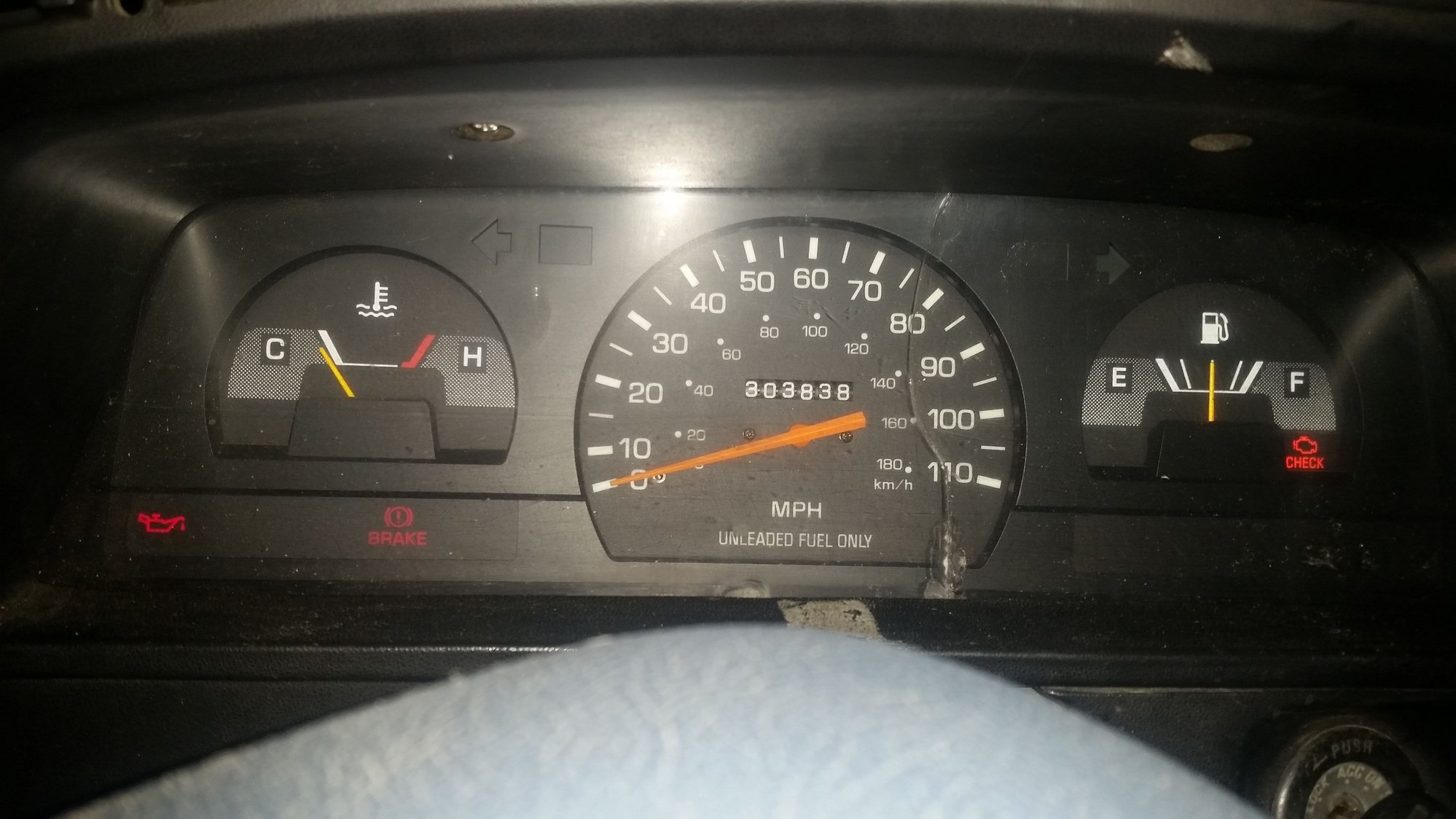

These are the only dash warning lights I have
I have checked the bulbs, they're good.. is there a chance my model Pickup doesnt utilize alternator or battery lights?

The battery / alternator /charging warning light is the same thing.
Your truck does have one. It appears the charging warning light isn't working.
Here is a great thread by RAD4Runner that details how the charging system works: https://www.yotatech.com/forums/f116...s-22re-304868/
The thead is based on his 1986 4Runner, but should be similar to your Truck.

On first gen MoreFunner, If charge fuse is busted, you would not get ANY actual charge fault light or upon IGN on. However, charging system would still work, Yeah, Toyota electrical engineering in the old days.
