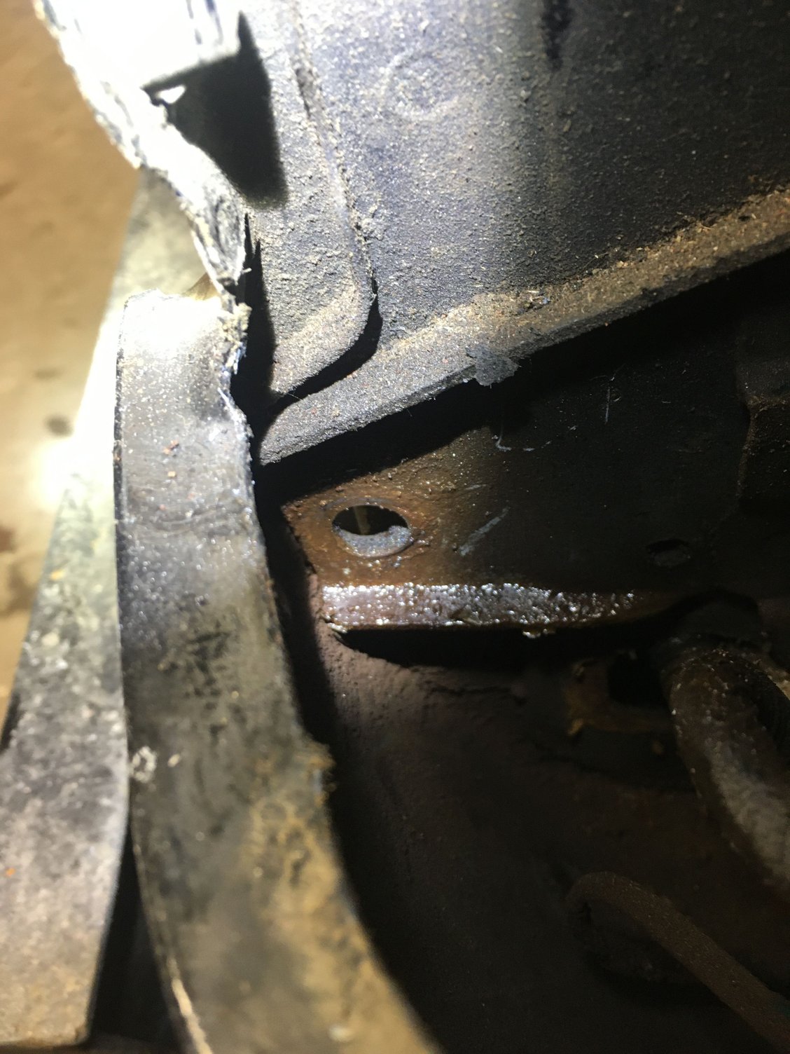

Nuts holding either side of tailgate are supposed to be welded to body? Both mine are not welded any longer. I’m just guessing they should be welded on. Anyone know for sure. Fixing my tailgate and it’s now removed.
pic is of hole where bolt acts as hinge for tailgate. Thanks

Old Dec 20, 2021 | 09:20 AM
slacker's Avatar
Joined: Jan 2006
Posts: 6,384
Likes: 304
From: BC Canada
yes .. they are welded
Old Dec 20, 2021 | 12:30 PM
2ToyGuy's Avatar
Joined: Jul 2005
Posts: 2,345
Likes: 657
From: Chiloquin, OR
Or WERE welded, in your case

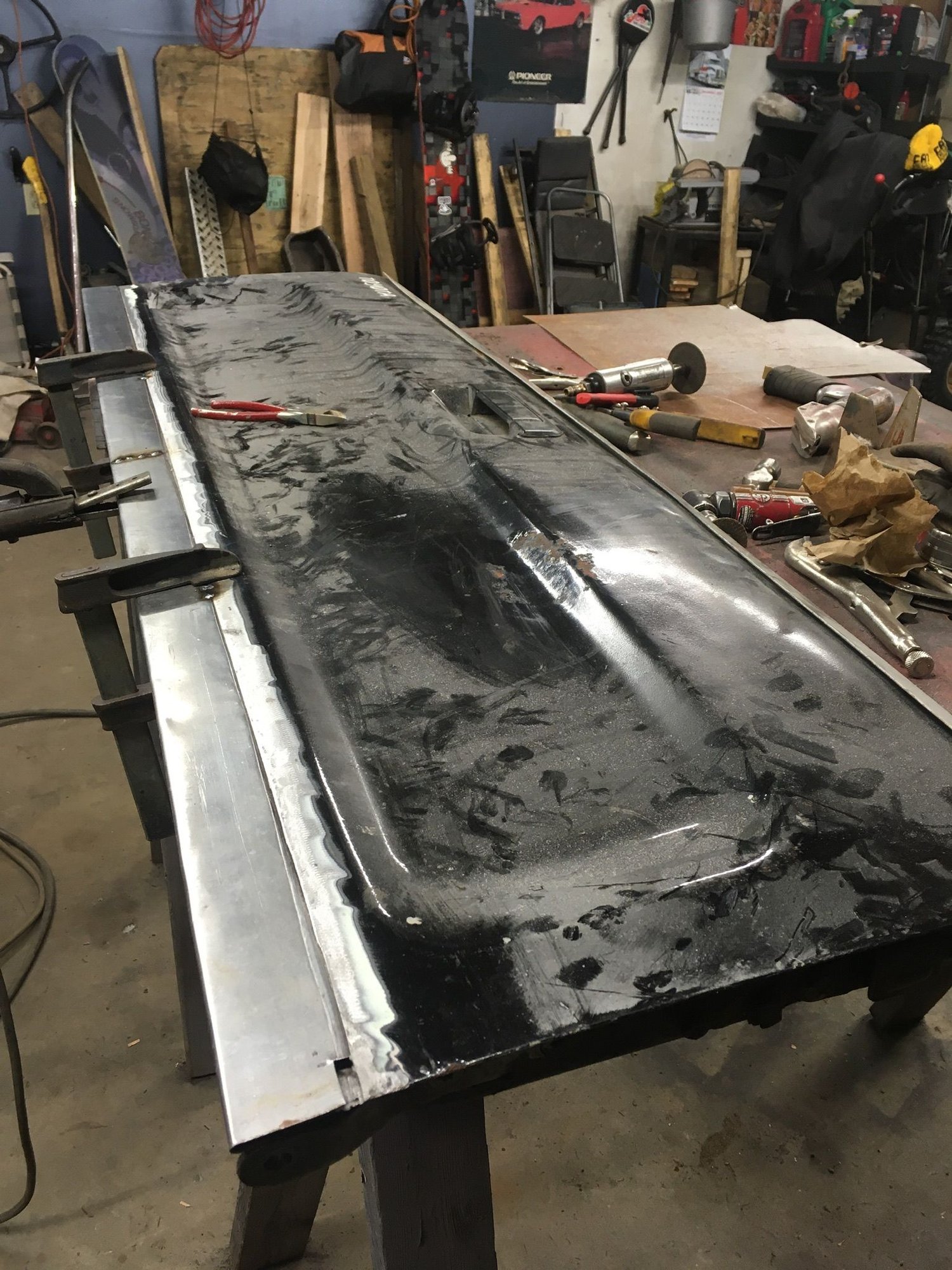

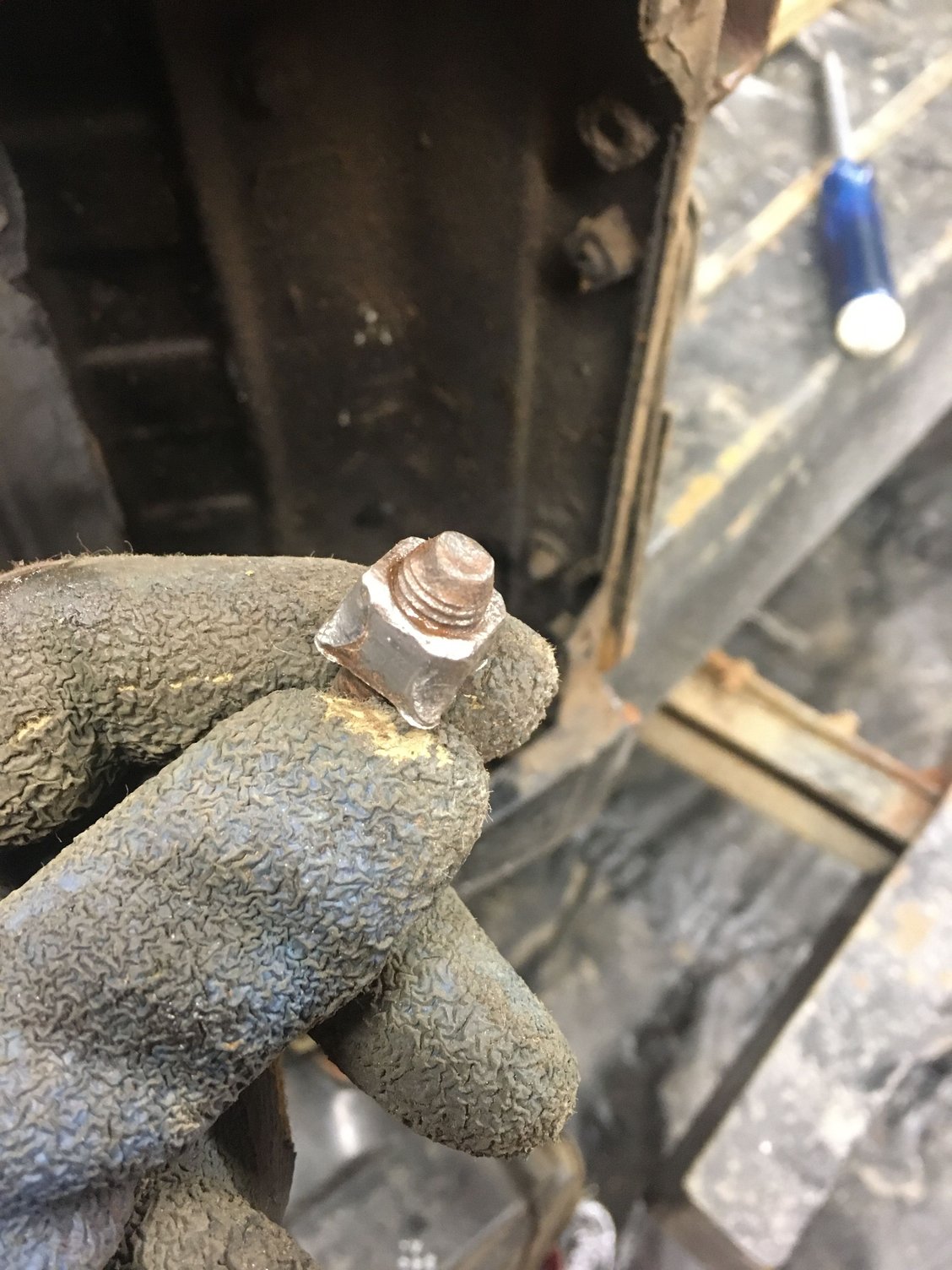

Tailgate been rattling for some time so decided to fix the hinge and explore the two small holes in tailgate which leads to this
