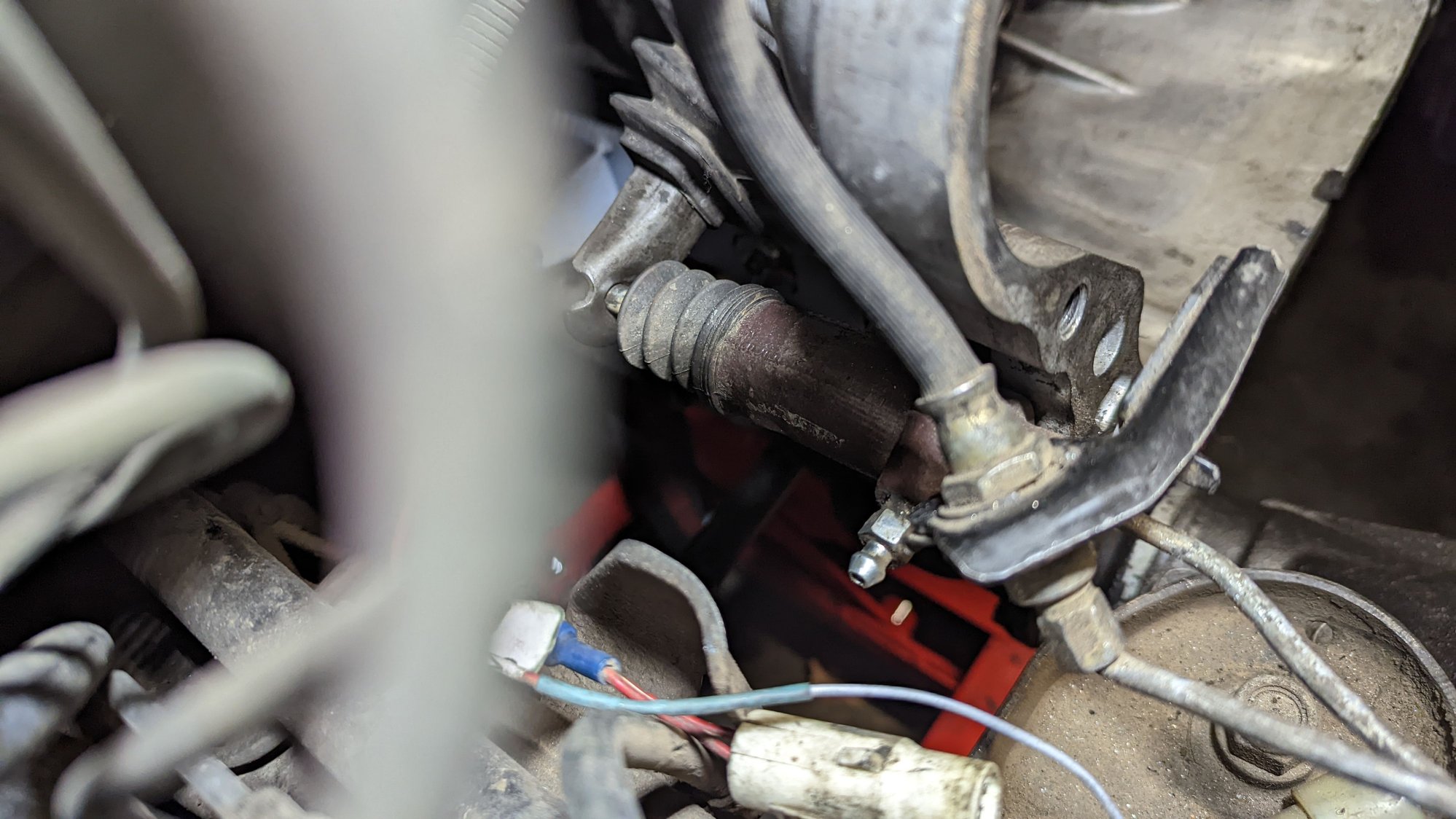

I have the engine out doing other work, and just got the throw out bearing re-installed. It definitely looks like it is sticking out too far on the slide. Makes me think there is pressure coming from the clutch pedal? The release cylinder is definitely sticking out further than I recall too, but maybe my memory is off...
There is also a tiny kink in the clutch release cylinder hard link (right at the flare nut) but I don't think that's the cause of the problem...
Will incorrect pedal height/free play on the clutch pedal cause this?
Sticking too far out
release cylinder over extended?
potential kink in line

Actual pedal height is irrelevant,
What is essential is that both the clutch master and brake master actuating rods retract enough for their respective pistons to come completely back on their outer stops.
Only when those master pistons are completely rearward with slight freeplay at the actuating rod and master piston interface, can any residual hydraulic pressure be relieved.

Thanks Millball, exactly what I needed to hear.
I shouldn't worry about the return spring in the release cylinder on the clutch "pushing" back too hard on the pressure plate fingers?

Should be no issue so long as the clutch master piston is full back so that the master cylinders relief port is clear..
