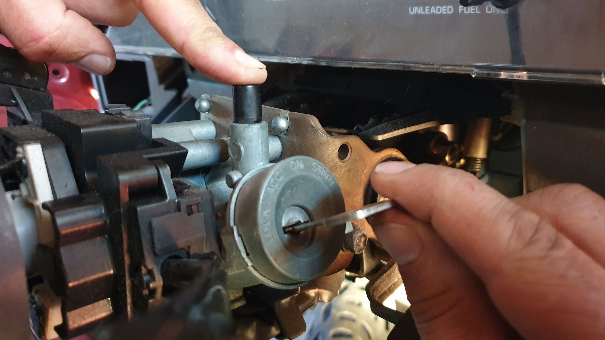

Do you know how to remove the ignition key cylinder?

With the key turn to acc. Then use a pick or similar tool to push the pin on the side. While the pin is pushed in you should be able to pull the lock out

I can see that pin here:
https://www.yotatech.com/forums/f116...locked-277237/
but my 4R doesn't have it in the same position.

Maybe a little further back? Partially obscured by the t.s. assy?

I have to remove the steering wheel to access to it, or do what this guy did

Removing the steering wheel isn't a big deal, just make sure to mark the position on the shaft before pulling it off so you get the splines aligned right when you reinstall. The other trick is to loosen the nut, but leave it on the last 3-4 threads. Then grab the wheel at the 9:00/3:00 position and pull/rock back and forth. Pull like hell. The reason you leave the nut on is so when the wheel does finally let go you don't smash yourself in the face.
That said, I think I'd find something a little thinner than a 16 penny nail, like a pick with a 90 degree bend at the tip. You should be able to snake it in their and push the pin in.

I have 2 4rs, in one of them, to remove the key, I must go to ACC position, push the famous button in the steering wheel column, turn the key to LOCK and then remove the key. I think that is the way.
But in the other one, I can remove the key from whatever position it is in the key cylinder, I don't know why and that is what I'm trying to find out.

To push in the pin the lock must be in accessory. Once you push the pin in you should be able to just pull the lock cylinder out. You don't need to turn the key "lock".
If a key can be removed from the cylinder in any position that's from badly worn wafers(tumblers) inside the lock, along with a worn key. Every now and then a new key cut from code will fix it, but more often than not you need new wafers, too.
If the key is stuck in "lock" and you can't turn you can try jiggling it up/down while turning. Usually a build up of old oil and metal shavings from the key jams them, and if you can shoot oil in there you might be able to flush enough junk out to rotate the key. If everything fails then the last option is to get a punch and drive the pin in with a few hammer blows, but at that point you've lost the lock. ASP should have a replacement lock, but it'll come with a new key code. if you can extract the lock without damaging it you can rekey that one once you locate the parts
Rekeying a lock is pretty simple, but getting the wafers can be a pain. Most locksmiths are not helpful. There are 6 wafers in each lock, with four different sizes available. If you have a ultrasonic cleaner it does wonders for cleaning a lock up before you start taking it apart. Each wafer has a little spring, so it helps to have a tray or something to work on so you don't lose anything. The ignition lock is the easiest to learn with since it doesn't have the chrome bezel like the door locks.

That happens as they wear, over time. Both mine you can pull the key out with the truck running, off, whatever.
I am, BTW, still using the keys that came with each truck from the factory. But, even with a new-cut key, you can still pull it, so it's the lock cylinder, not the fault of the key.

That is the problem, I can pull the key out with the truck running, off, lock, etc without pushing the steering column button. That is what I'm trying to show in this pic (videos next time ) :
It works good in the other 4R:
They keys are new.
So the problem is worn wafers (tumblers).
Thank you Jimkola!
