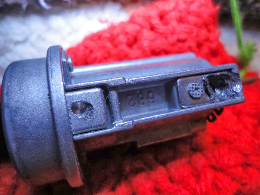

Steering wheel/ignition key locked-dsc08444.jpg
Steering wheel/ignition key locked-dsc08445.jpg
Steering wheel/ignition key locked-dsc08447.jpg
Well, I managed to drill enough for the cylinder to finally come out, now what? I thought once the cylinder came out the steering wheel would be unlocked. I also thought the thing holding the cylinder in was the thing locking it but I still can't turn it (with key in.) I saw a small bronze pin and I tried drilling on that as well but still no luck.

Steering wheel/ignition key locked-dsc08449.jpg
One more picture

Well, I used some needle nose pliers and grabbed on to the thing inside the cylinder and got it started. I am still curious how to go about fixing the lock though, I read something about taking the tumblers out, how do I get inside the lock cylinder I posted pictures of to make it turn again? Or would I just need to order a new one?
