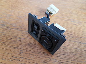

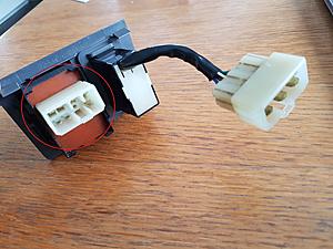

Hi guys,
my brother got me a pair of power mirrors and the switch to operate them time ago.
I installed them in the doors and connected them to the door harness pigtails. That was easy. The problem's I can't find the pigtail in the dashboard harness that goes to the switch (please, see red circle).
Please, help me to find it.
Thanks!

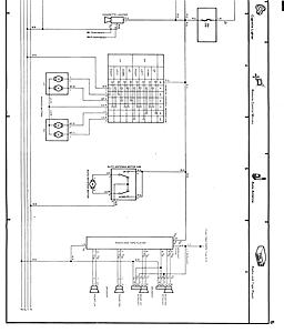

The electrial wiring diagram says it's the red wire with green stripes from the radio/tape player and the antenna switch that goes to the power mirror switch. I dismounted radio, safety pad (dashboard), and everything under the instrument cluster, but I can't find a plug that fits the switch. Maybe the switch's from other year/model, as you said.

Another likely possibility is your 4Runner may not have the wiring for the power mirrors from the factory.
Toyota did make different harnesses depending on the options the truck was going to have rolling off the showroom floor.
If the wiring and connector are in your dash, they should be right around where the power mirror switch gets installed, maybe taped up out of the way.
The diagram shows that the power mirror switch gets its power from the Cigarette Lighter Fuse.

looking at the 1988 EWD the power comes from the cig lighter fuse .
If your vehicle has the plug it should be blue

The power mirror switch gets power from the cigarette lighter fuse, and receives ground and 5 wires from the mirrors.

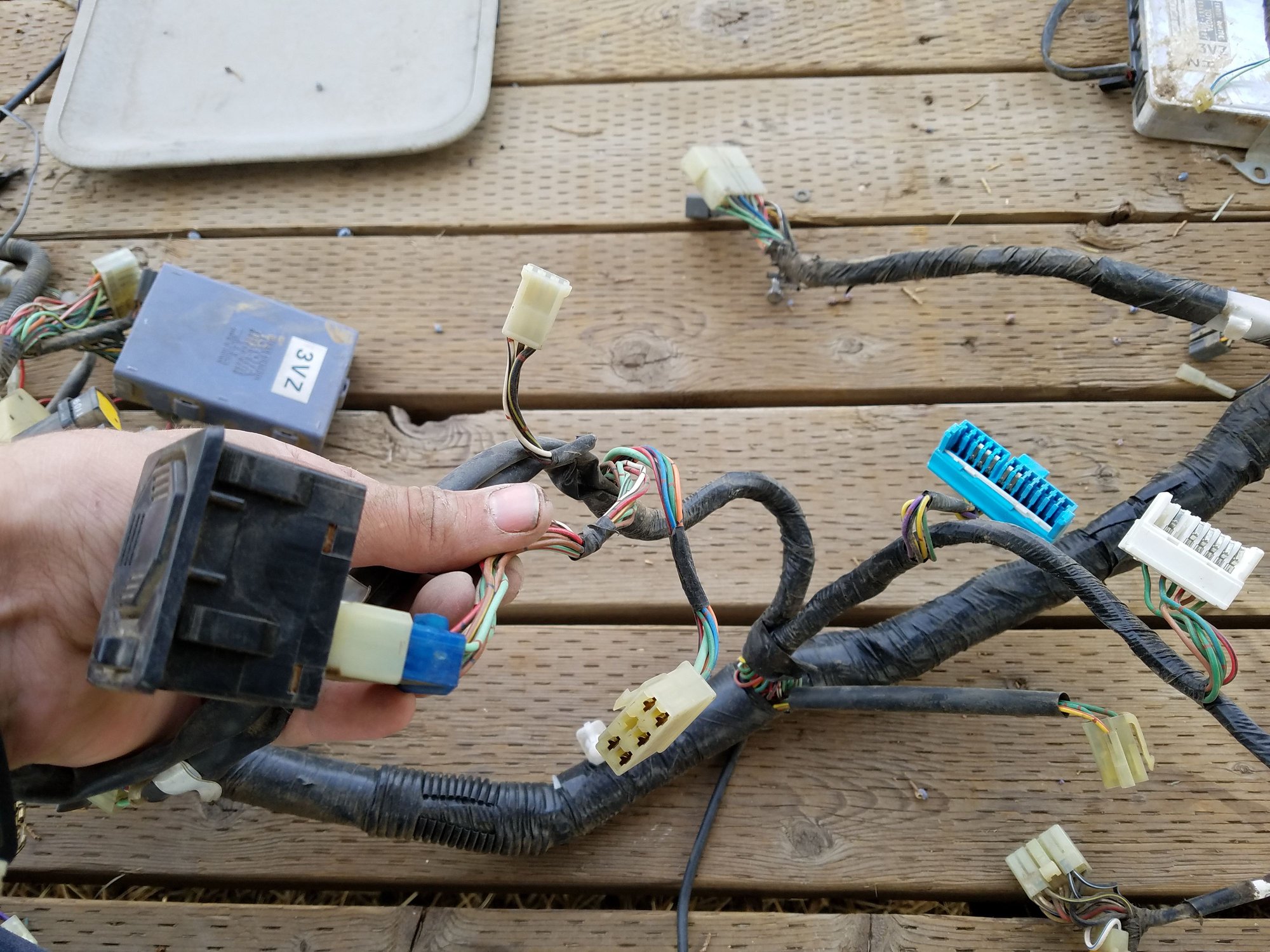

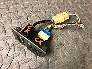

Hey, don't know if this'll be useful, but here is the connector location on my 89's wiring harness. Looks like it's part of the sub-loom to the driver's side of the gauge cluster loom.
Thank you! those pics're very useful. My T4R 88 22re doesn't have that blue connector, it should be near the rear window defrost switch, but it's not.
I'm looking for that blue connector to be able to modify the harness I have since I created this thread.
Old Oct 1, 2018 | 10:13 PM
Snoop_Todd's Avatar
Joined: Sep 2018
Posts: 21
If you message me a mailing address, I'll hack it off and send it to you.
