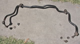

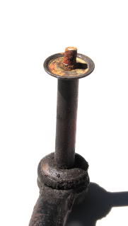

If it looks like this leave it off. You would probably never tell the difference.

Tuef,
Note that it's just your end links, not the whole sway bar that needs replaced. Take a 2+ lb sledge to that rusted stud, and it should pop out. Then just reinstall. Definitely use anti-seize on the threads before putting that final bolt on.

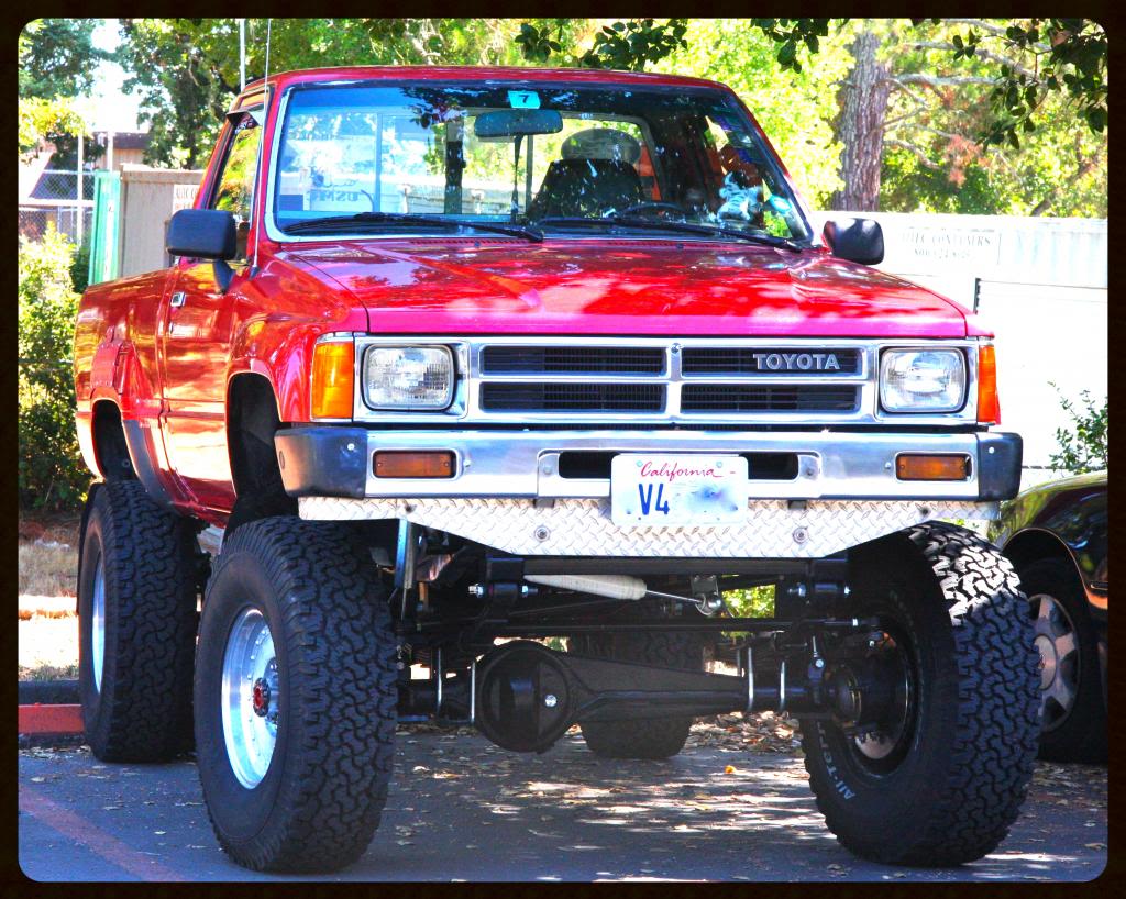

RSR thanks for the reply. I know have an SAS. I thought I would add what I did when I had IFS.Name:  ac174595-a49d-42fe-8786-5db3fd6ed222_zpsbfdda256.jpg

wow that turned out nice, your poor dog is gonna need a stepping stool to get in!
