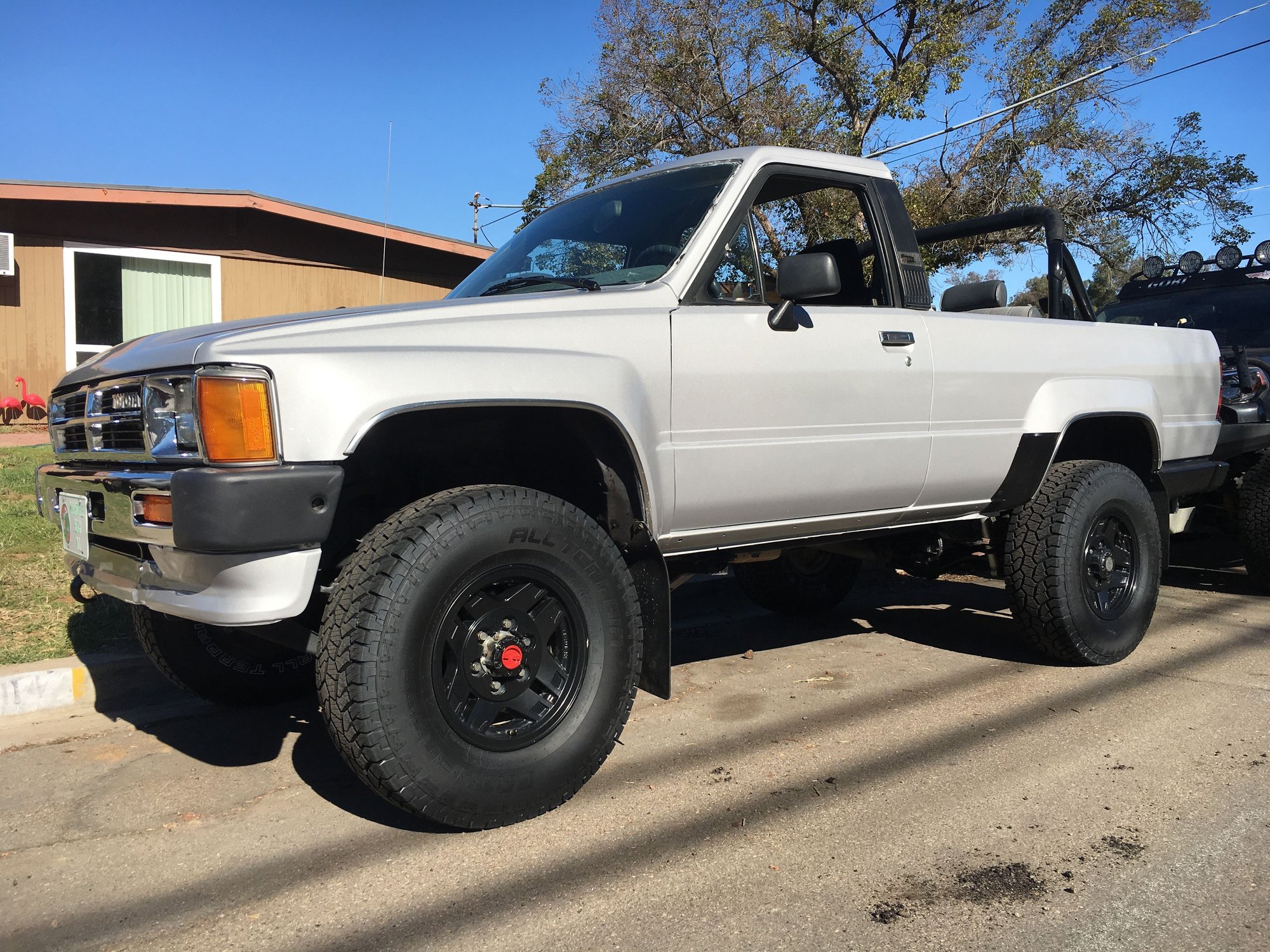

many of you have been checking in on my restoration 87 runner. im at the point where i driving it daily and the ride quality is getting obnoxious. i know its a 31 year old truck, no need to point that out, but my current setup was a "enough to get by" fix when i first bought it. its factory torsions adjusted just a hair and an add a leaf in the rear on what i believe to be oem sagged out leaf packs. i have kyb gas shocks all the way around that are brand new. the rear it was really kills me, the add a leaf is far to harsh, i think it was rancho? at any rate my question is simple, whos completely happy was an after market suspension that isnt running a rock crawler / trail rig? im not opposed to having a 1-1.5 inch lift, seeing as how im running 31's at the moment. im looking into the ome light duty suspension but im afraid it will be more lift than i want. heres a picture of current ride height/stance that id like to keep. do thicker torsion bars make much of a difference with ride quality or are they more for load bearing?

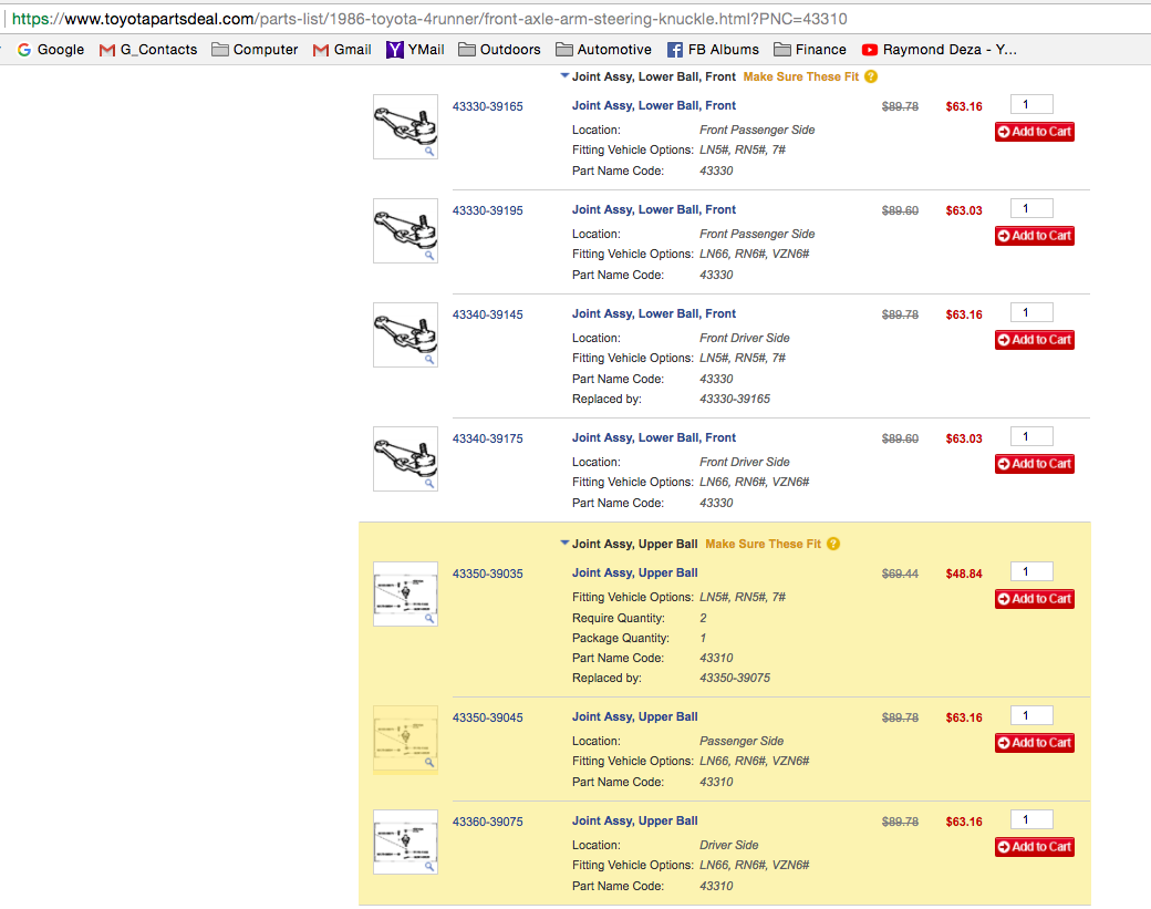

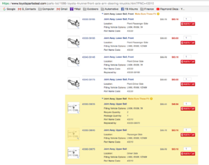

Originally Posted by keycw
...the beck/arnley products from rockauto are oem, like literally the exact one from the dealer right down to the 555 stamp and the cost 30 bucks as opposed to the 75 which was the cheapest my dealer friend could get me...
Please see screen caps form Toyota Part Deal. Quick shipping, and I think local to San Diego.
I do not trust Beck-Arnley for critical parts. Poor quality control. Ask me how I know.
Its not a matter of trusting beckarnley, what im saying is beckarnley is selling the same part. If my iphone would let me post the pick from the rockauto website id show you ha. Its the same 555 part from the dealer, and its sold by albeckarnley for 35 bucks, the 555 is clearly stamped on the balljoint.
