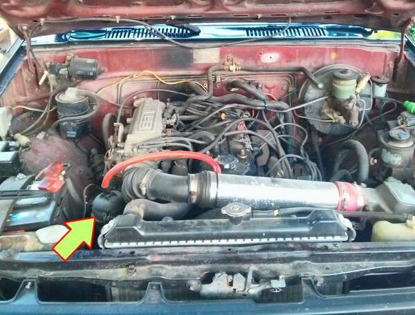

Are u talking about this thing?

Cuz thats what im talking about.

Negative ghost rider. I was talking about the cylindrical looking one to the left of the engine attached to the firewall.
Ignore all prior advice from me. Mine doesn't have that one.
