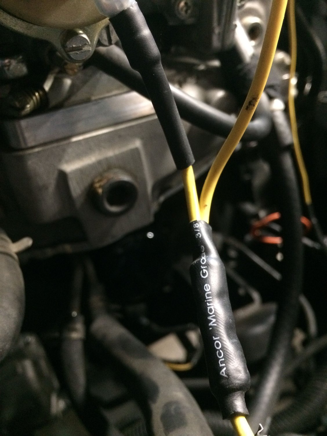

The solder vs crimp discussion is an interesting one. I use to think solder was the way to go, until when wiring my boat a West Marine guy told me it was a no-no by itself for marine connections, which I have since verified:
https://www.westmarine.com/WestAdvis...nal-Tech-Specs
As I understand / observe, soldered connections force all the movement to be where the solder stops, whereas crimped connections allow fatigue to spread over a larger zone. Solder makes for a better electrical connection, but crimps make for a better mechanical connection. But I'm sure RJR is correct that automation is the PRIMARY reason for auto manufacturers using crimps, and that PROPERLY soldered or crimped connections won't be the problem, poor wire plumbing will be.
Having spent more time than I'd like chasing down electrical gremlins due to wire-nut indiscretions in my twenties, I now use a belt-and-suspenders approach to automotive wiring: marine grade wire, crimps, and connectors, with marine grade adhesive heat shrink. The marine stuff is expensive, but the heat shrink especially is a world apart from your basic parts store stuff.

Used tools and electrical connectors I have available. Cleaned the wire, installed a shrink-fit connector, using my "pro-Crimper" I use for crimping spark plug wires, crimped the connector then used heat gun to shrink connector to wire, used shrink-fit sheathing over the repair gave it a few heavy tugs and so far all is good???

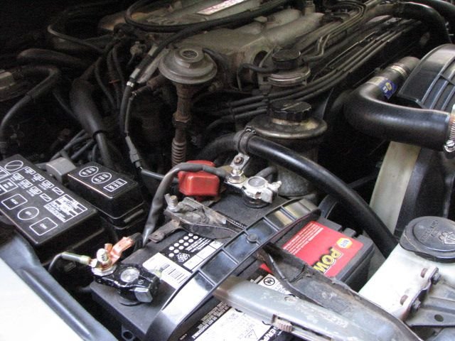

if it were me, I'd replace the "wing nut" battery connectors with real crimp-on ones. Those connectors seem to be a corrosion-magnet in the best of cases, so I'd like every advantage.
But what you have should last, oh, 10 years. At which point your truck will be 40 years old. So it might not matter ....
Good job working the problem.
Agree I need to replace the wing nut and repair the ground strap but after taking the vehicle to the shop to replace the starter and they came up with this $80 solution not sure how long I will keep it this way before determining when I got my monies worth?
I am as bad at soldering than I am at welding and rarely do I post photos of my work with either. The soldering information is very helpful; again thank U's all for the help!
