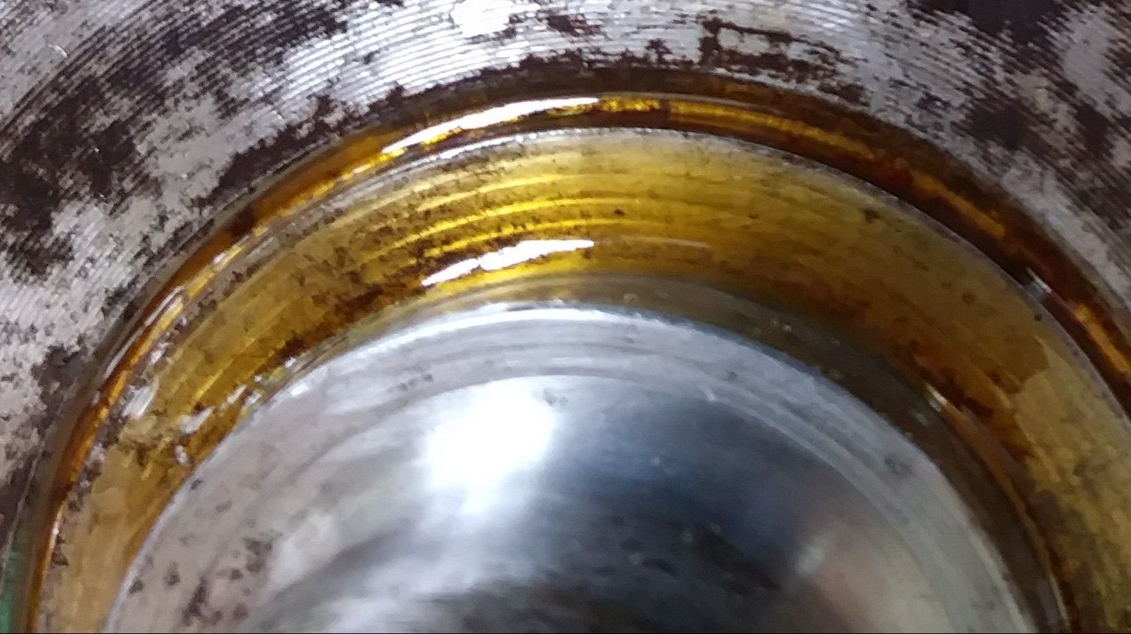

I've been chasing a bouncy/shimmy/vibration issue on the front passenger side. I pulled the hub once again today to start looking at the knuckle as the problem. There is wear on the shoulder where the inner bearing is located when the hub installed. I have a spare knuckle I pulled from a pick your part last year, just to have one on hand just in case.... The spare doesn't have wear.
Would the wear cause an issue with the bearing functioning properly and causing bouncy/shimmy/vibration rolling down the road?
Is this normal wear for 324K miles?
Is the wear caused by the spindle nut being overtightened?
Original Knuckle with the wear on the shoulder
Spare knuckle, no wear

This spindle wear is VERY unlikely to cause shimmy or vibration issues if the bearings are in good condition and adjusted to the torque and resistance specs found in the FSM
Such wear is usually found after long service where the bearings were run somewhat too loose, permitting the bearing inner race to turn on the spindle
. (Spindle nut UNDER tightened.
No cause to change the spindle out though unless the wear is Extreme.
I would call extreme, anything approaching a 32nd of an inch or so.
Did you roll the whole tire/wheel rotating assembly to check for runout before disassembly??
I have run many different machines many tens of thousands of miles with substantial spindle wear.
You ought to be able to take a measurement with a decent caliper, or better yet, a micrometer to determine how much wear actually exists.

So my plan yesterday was to put back on the hub with the new bearings. Before doing that I inspected the knuckle to find the wear on it.
The flat area on the knuckle is about 5mm. The wear starts about 4 mm. The wear is diagonally.
