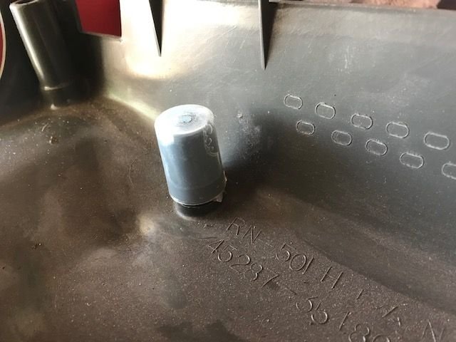

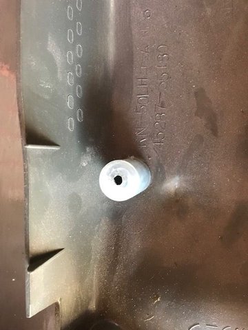

They typically break at that "tower" where the screws retain them. I found a plastic cap off a bottle that fit nicely over the tower and glued it in. Then drilled a hole in the center of the cap. Worked great.

I've used a straw over what was left of the broken "tower" and filled it with JB Weld, drilled it and good to go as well. I JB Weld the heck out of the broken plastic and it seems to hold up. Been a few years.

MacGyver?! Please. Coupla caps and a small tube of adhesive and I have a "Steering Column Cover Repair Kit" just waiting to be retailed for $24.95 on our favorite internet sites.
The first 149 buyers will get a chance to buy a second kit for 15% off. A slight handling charge of $9.95 will be added to compensate me for the discount.
I took it off today and took pictures. I'm pretty sure the cap came off my pump sprayer for lubricating oil rings. Nothing special. I remember being shocked how well it fit. I used Silicone adhesive to install. i wanted something relatively easy to remove in case it didn't hold up. Been good for 2-3 years.
The nice thing about the cap is it "sleeved" the rest of that tower to give it strength further down
