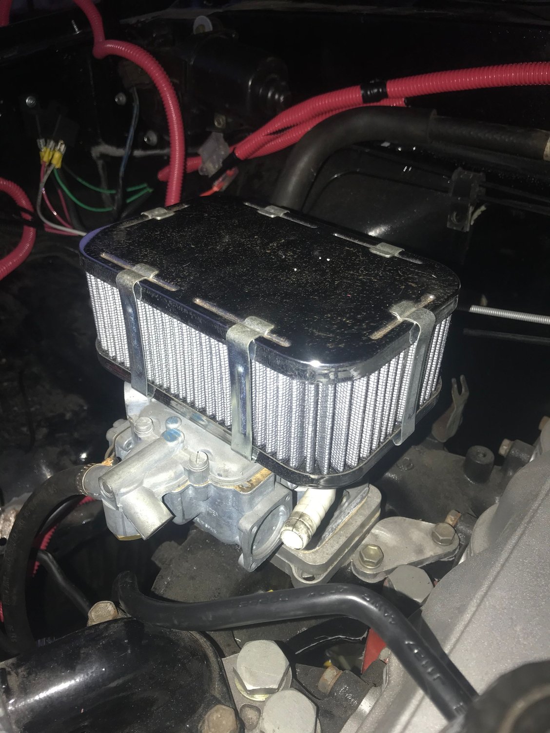

Thanks for the reply.
I forgot to add some things.. I do have a fuel pressure regulator and I do have a new fuel filter. I’m not sure if the fuel pump worked before.
Responding to 3.
My question and your answer seem to be mixed up. My question was “I don’t need a return line. Correct?”
your answer says “Yes” and then says “in tank fuel pumps need a return line”. So do I need one or do I not?
There should be a fuel pump in the tank. But, my electrical fuel pump is external and mounted on the frame. (I would provide a photo but it can’t seem to upload at the moment)
I have a carb, I don’t have a fuel injected. I do hear air coming out of the gas tank when I take my cap off.
Where would my return go?
I’m coming to the answer that my fuel lines are clogged. But I don’t know how to re-route my fuel lines. Where does “VENT” and my “RETURN” (if I need one) go to? Are there any thread links that you know of? Or do you have an explanation? I’m gonna keep trying to research some threads

Sorry about the confusion, you need a vent line. The vent line is one of the three lines coming out of your sending unit. It's literally just a hole in the top of your fuel tank and should run back to your charcoal or evap canister in your engine bay to trap fumes. Un-loop the return and vent lines and run a line from one of those to your evap canister, mainly to keep water from getting in the fuel system. If you're not going to use a return line, cap the other one off. Note** Can't see what's below the sending unit, so not sure what the pick up tube looks like. Is there an old factor fuel pump on there or something or just a tube with a sock on the end and the fuel gauge float??
Since you have an external fuel pump, depending on which one it is, you may not need a return line. With an external fuel pump, it should be mounted at or below the bottom of the fuel tank. Electric fuel pumps are better at pushing fuel than pulling it, so any help you can give it from gravity will make it last longer.
If you need a return line, here's an article on how it could go. It's basically to bleed off fuel the engine isn't using.
https://www.racingjunk.com/news/get-...sepower-needs/
For you current non-fuel problem, I'd try blowing out the fuel lines with some low pressure air. Blow back to the fuel tank and see if you can hear some bubbling. Also listen to see if you can hear air escaping, I've had a metal fuel line develop a hole before, so now the pump sucks air instead of fuel. If you're not certain about the fuel pump working, check that out too. I'm not a huge fan of out of tank electric fuel pumps since they are prone to burning up faster than in-tank fuel pumps. My advise if you're going to keep that set up, carry a spare one. Just curious, why not use the mechanical fuel pump set up with a carb? It's simple and reliable for you're set up. (Assuming 22R with a Weber carb)

Hey, sorry for the late reply. But here is what I found and read abit on
https://board.marlincrawler.com/index.php?topic=25888.0
Im only running electrical fuel pump because I bought it from the previous owner with one. Didn’t seem to work though (I towed the truck home) Also because I’ve read up how some people have ran into problems with mechanical fuel pumps in the past.
So I’m fine with going this route. At this moment I’m planning on dropping the tank and checking in the tank and also blowing out those lines you were talking about. That must be my problem and I hope it solves it. But that link above also talks about how there’s no fuel pump inside the tank for 22r’s w/ Weber carbs. I’m a noob w/ questions and I guess I didn’t know that? Haha.
So I guess I need to drop the tank and investigate and learn myself..
As for my return line.. I’m gonna cap it off.
and my vent line, I can just leave it uncapped and run it into atmosphere correct? I also don’t have a charcoal canister because it was previously deleted. So thats another reason why I don’t want to route my vent line. Any one else have any answers? Hopefully have some results soon. Thanks again. Aloha

Venting the fuel tank to the atmosphere will work, just won't pass emissions if you have to worry about that. I would put something on the end of the vent line, like a simple one way valve to keep water, dirt, or whatever from getting in the tank and run it higher than the tank.
If your's didn't have fuel injection to start with, it wouldn't of come with an in tank electric fuel pump, only one mounted on the side of the head on the front passenger side. I'm assuming you have a block off plate there now. If you do decide to go mechanical fuel pump, make sure the cam is still there over the timing chain that drives the pump. Easy to spot if you take the valve cover off. It's not normal to take it off because you need it as a spacer, but you never know what a previous owner did. Same with what may or may not be in your fuel tank, vehicles with 22R's didn't have electric fuel pumps, only the 22RE's, 22RET's and 22REC's. If you have the problems with carb fuel inlet conflicting the the fuel pump like that article had, maybe consider a spacer at the bottom of the carb for clearance?? I've done that with older V8's with 4 barrel carbs to give them some clearance off the intake to miss something that conflict with linkage, etc.
Did you ever get it to fire by putting spraying carb cleaner or putting gas in the top of the carb? When I was trouble shooting mine, I could get about 30 seconds of run time with putting a little gas in the throttle body. Hopefully blowing out the lines solves you're problems and you'll be wheel'n in no time!!
