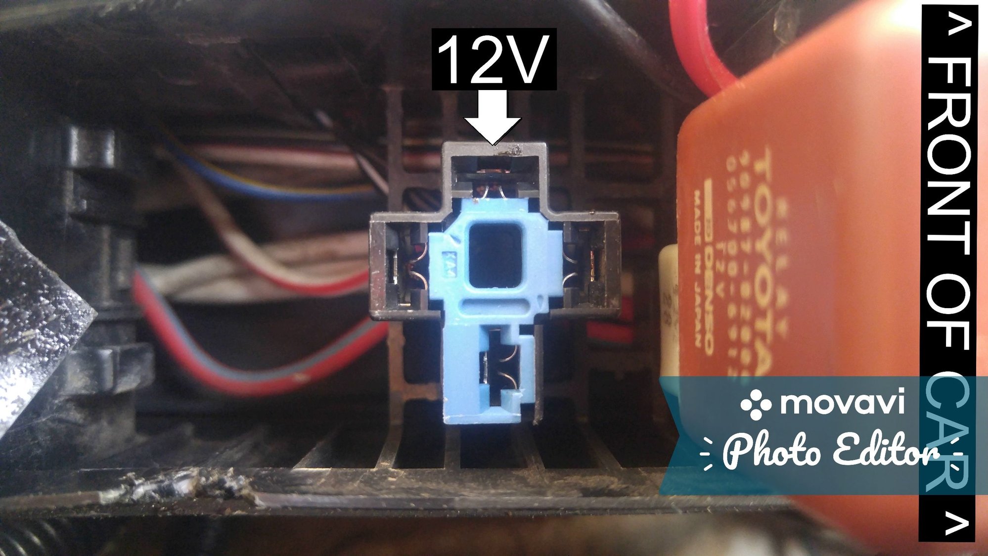

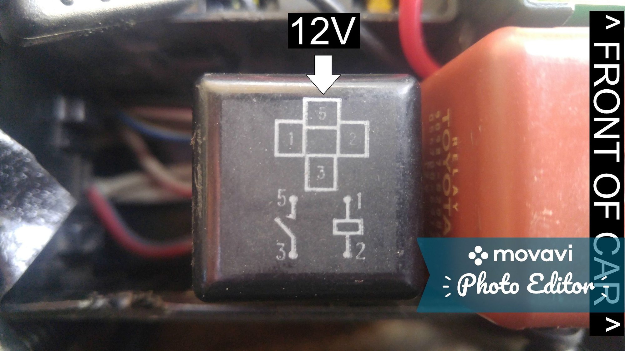

Yeah that must be the ADDED starter relay
Make sure:
1) Either (ONLY one of them) Pin 30 or pin 87 is always connected to the battery through a fused line.
2) Relay is wired like below (pins 30 and 87 are interchangeable):

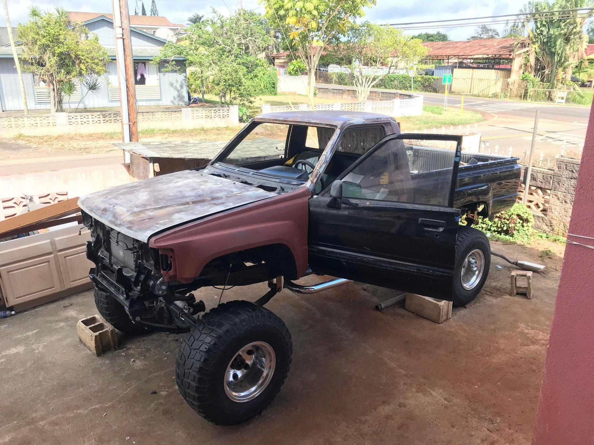

Anyone change out their ignition switch? I re-routed my existing starter relay years ago and though it fires the starter up, recently I think that the switch (essentially the "incorrect" factory wiring) has worn out to the point that it wasn't sending voltage to the COR that powers the fuel pump. I wonder at what point the ignition switch fails, mileage or age-wise so that you get the intermittent no start. I'm still learning about electronics and no expert but, are electrical components like ignition switches supposed to last 30+ years? Did the engineer that designed this system really think that decades later there will be a group of dudes connected through this thing called the internet discussing relays and kill switches?

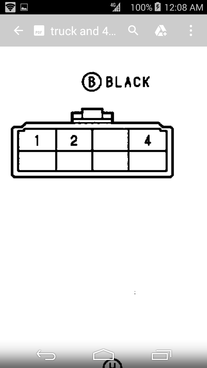

These last two questions are kind of related.
If you do a voltage drop test across the ignition switch and get a none zero reading the switch could use a rehab.
measuring voltage across pin 4 to pin 1 and pin 4 to pin 2 a "dirty" contact will show a non-zero voltage when loaded (held in the start position).
Pin 1 (st1) feeds the starter & coldstart
Pin 2 (ig1) feeds the clutch start cancel (which in turn may feed the starter relay)
Somewhere around here are photos of the ignition switch, it's a simple reed connection which can be cleaned and polished.

NO.
1) The BLK wire that connects to the relay contact should always have 12V. This should directly connected to battery via a fuse - as in 1990-1995 4Runner schematic* below.
2) The BLK wire that connects to the relay coil should ONLY have 12V when IG SW is in Start position.
3) The BLK-Red should only have ground if clutch is depressed far enough or IF clutch safety cancel is activated.
4) BLK-WHT should only have 12V when starter relay clicks (contact closes)
*schematic showing correct wiring does not guarantee that truck was wired​​​​​ correctly at the factory

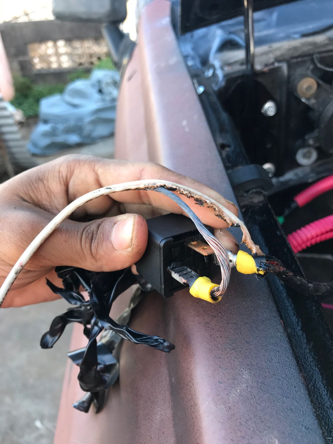

88 Toyota Pickup 22r swap starter relay problems
This is gonna be a long one! Any help is greatly appreciated.
So I have a 88 Toyota Pickup with a brand new rebuilt 22r in my engine bay.
I’m trying to get my starter wired and I’ve been reading through this thread and watched a couple of YouTube videos. Here is my research put into testing. I will also provide some pictures to help explain.
First off -
I can’t seem to find my starter relay in the engine bay. I’m sure my ignition isn’t working and I’m fine with wiring a new starter relay in then creating my own switch to run to the cab. I also don’t have the STARTER SIGNAL WIRE. Which I’m guessing is tied into the key ignition which will switch the starter on.
I first went off of this video.
I then ran into the problem that I didn’t have the STARTER SIGNAL WIRE
Starter signal wire shown in the video I went off of.

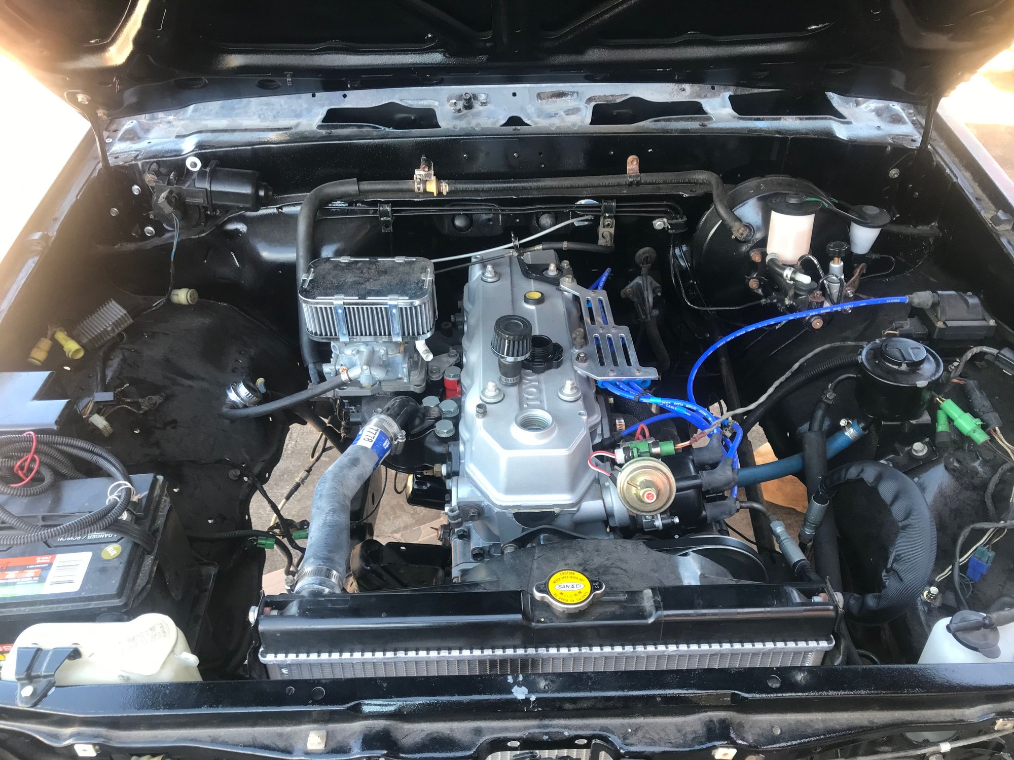

Here is my engine block. Is this where that starter signal wire is supposed to be?? And that is TYPICALLY supposed to connect to my starter solenoid correct? I also did try to bring a female connector with a 12 gauge wire to the “S” on the relay. But that didn’t seem to work
As of now, my plan is to re-do this setup with this relay and then go off of the “S” on the relay and wire it to a switch. (Is that what my “S” is for on the relay?)
Here is it wired for TESTING purposes following the video.
I think I used 6 and 8 gauge wire for these. I got this relay off of amazon and honestly, the screws seem abit worn and are REALLY loose. So I may need to get a NEW one to accurately test with this method of wiring again.
Now -
Here is another alternate route I took to try and get the starter cranking. Which I did end up being successful in. (Cranking and almost getting the engine to completely turn over. Just wasn’t getting any fuel into the carb) But........ I’m guessing my wire was too thin or I miswired something soooooo my wire melted
Heres the story.
So I just to the store and bought a regular 40A relay with 30,85,86, & 87. I then began to wire my relay to a switch.
Here is that relay wired.
86 connected from relay into my switch
So 30 (WHITE) is wired from my battery + into the relay (was fused with a 30A fuse)
86 (PINK) is wired to my switch
87 (PINK) is connected to my solenoid and jumped into my screw on the starter
85 (GREEN) is grounded to my engine block.
I also have another wire connected from my + on the battery to my switch. (No photos of the switch sorry)
Here is the relay (THE RELAY FLOATING) rewired after abandoning the previous wire attempt from above in the post (everything is disconnected from previous wire attempt.. I just have it sitting in the bay) My other relay screwed there is for an electronic fuel pump. It is wired the same way and it seems to work no problem. Both positives from the battery to the switch and relay are fused w/ 30A fuses.
Here is how I wired it from the starter. I only jumped the solenoid (pink) and the screw terminal (white) because of previous knowledge of the video I linked above. (Is this correct?) you can see I crimped them together. If not, how should I go about wiring this?
I can’t seem to find the STARTER RELAY found in this picture and thread. Yes I read through it..
Also can’t even seem to find these wires and connections in my bay at all. I’ll post a photo below showing the only wires that I do have.
Here are the only wires I have in my bay. Where do these connect and what are they for?
PROBLEMS IM HAVING:
1. Fuse to my switch always blows in the inline fuse after I touch my ground terminal to my ground on the battery. I rewired a couple times and blew a good number of fuses. Why? (Is this because of the jump on the starter)?
2. I went in the next day after these photos were taken and then rewired 30 WITH NO FUSE (on accident) flipped my switch and melted my 30 wire right into the relay. But.... the engine was cranking and just about to start. I just wasn’t getting any fuel into the carb for it to go. As I’ve mentioned before..
Isn’t she beautiful? Sad !
Lesson learned..
So my conclusions and questions I have are.
1.Do I need those bigger 6 and 8 gauge wires like wires before? Or do I have my starter wired wrong anyways?
2. If I use those bigger gauge wires, how can I run it into a female connector onto a regular 30A relay like this? They don’t make any 6/8 gauge female connectors that are 1/4” do they? Hahahaha.
Also, does that mean I need to go back to the first route? With that different model RED relay and then just run my “S” on the RED relay (in the photo above) to a switch. My only thing that confuses me with that RED relay is there is no 85,86,87 and 30 that I am more familiar with.
Also not getting any fuel to my fuel pump like I said but when I turn it on from the switch it keeps ticking loudly like it is on. Do I just need a new fuel regulator? That’s for another thread.......
But big thanks to RAD4RUNNER for all the info in previous threads. I literally just made this account to reply on this thread and get some answers. Any help would be huge. I try to work on this guy about everyday after work. I am pretty active so I reply if there are any responses.

OK< to be honest I had a difficult time trying to follow how you wired to the starter and starter solenoid. From this picture I think I can tell you what your problem is. That black wire, going to one of the solenoid CONTACTS, the one with the threaded stud, needs to be a much larger wire. 4 gauge I think. Looks like you have a 14 or 12 gauge there. Look at that very short blue wire that comes out of the other side of the solenoid, you need to match that or bigger. The starter pulls in a lot of current. The solenoid much less.
