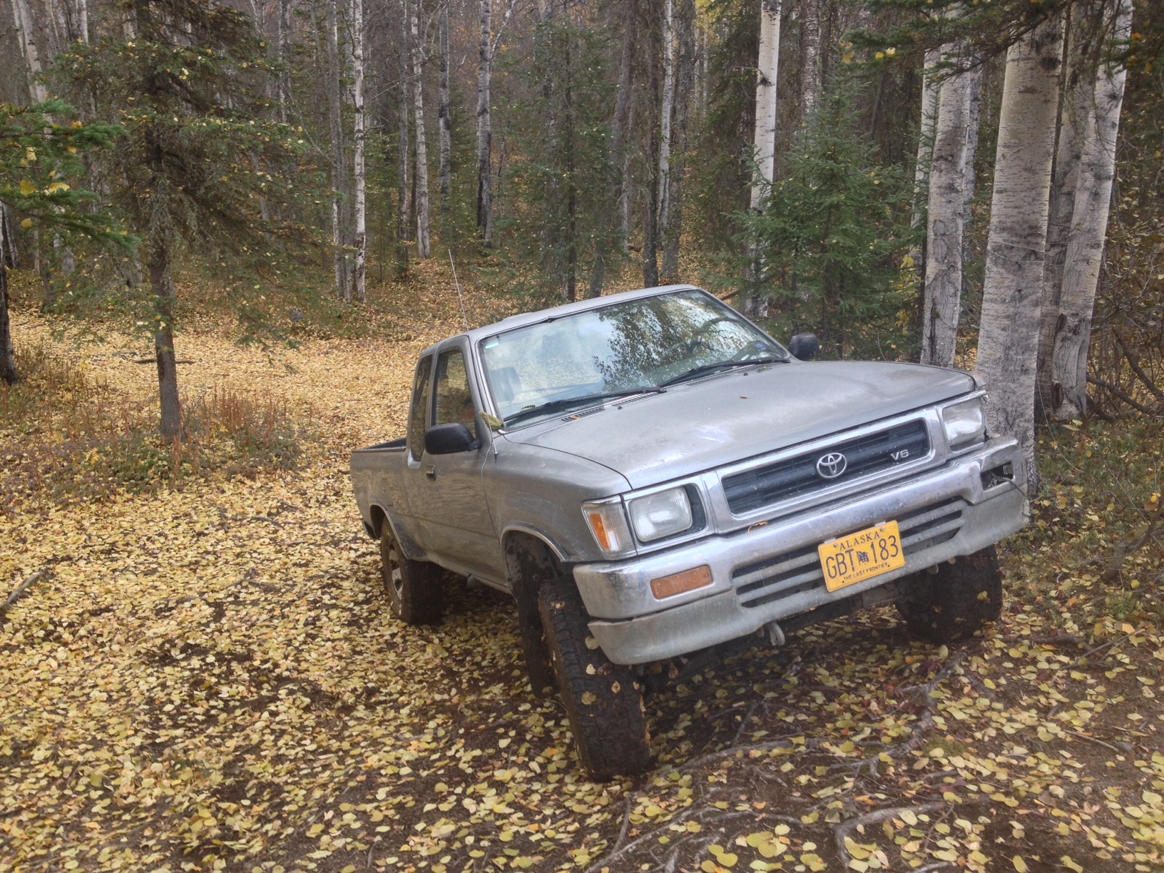

94 pickup V6 4WD. The starter worked for a few months fine, and for the last two months has been emitting a grinding noise when I crank. After a few tries it will start like normal. Sometimes it starts first try, sometimes I'm afraid it won't start.
I wonder if the drive of the starter is going out, or if some teeth are worn out? It is winter here, so it's been through temperatures from -15F to 32 so far, and it hasn't really changed based on the coldness. I couldn't find anything like my problem on the archives.
