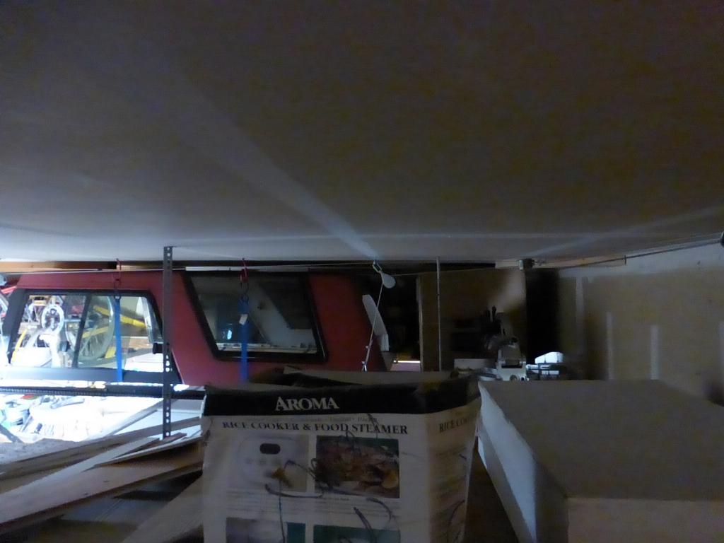

The start of summer brought with it some bad memories of a year ago removing the top for the first time. In an effort to save my back and marriage I spent memorial weekend rigging up a better way to go topless.

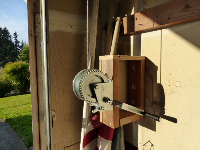

Harbor Freight 1,000 lb hand winch securely mounted to wall.

nice work...
i love how close to the ceiling it is..

Had to to clear the garage door.
