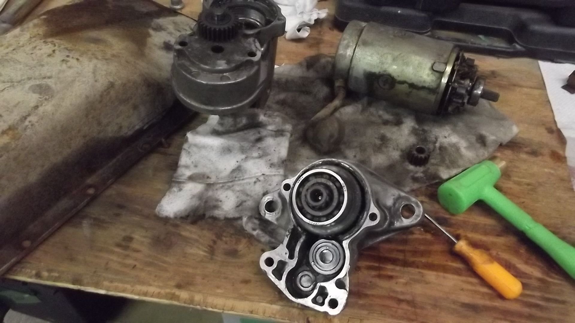

yes you can .. search starter clutch , I think rock auto has them .
Old Apr 26, 2023 | 01:42 AM
Jose Pena's Avatar
5 Year Member
Joined: May 2021
Posts: 55
great picture. I might just replace the starter gear. It might also be that since I reverses the flywheel gear instead of buying a new flywheel gear. It still has the messed up teeth but on the opposite side. Started might still hit the bad flywheel teeth. I hope replacing the starter gear will remedy this. Or I could add a shim on the bottom starter bolt and it might not hit the bad teeth anymore.
