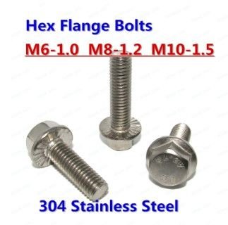

It seems possible to go with stainless steel hardware from ebay for about the price of zinc steel sourced locally. One listing has a set of stainless studs, though with zinc steel nuts and this made me wonder if all stainless would provide less holding power? Also, for the catalytic converter - front/intermediate tube joints, these m10x45mm bolts are comparable, but would the serrated surfaces would do well or is it is worth sticking with flat flanges?

They probably provide zinc plated steel nuts because stainless hardware will cold weld to itself. Look it up. Stainless on stainless will gall up and fuse to itself, especially if both the male and female thread are the same grade of stainless. The two will actually chemically bond and be impossible to unthread without destroying the threads. It's slightly less likely if the two parts are a different grade, but not by much. A stainless stud/bolt with a zinc plated nut is the way to go for the pipe to pipe exhaust flanges. For the hardware between the head and manifold, I'd suggest getting a replacement set from somewhere like 22RE Performance or LCE. Those studs take a beating as far as heat cycling goes. The higher grade steel will hold up better than stainless. The stuff from 22RE Performance comes with thread adhesive on the end that goes in the head, and distorted thread locking nuts which will keep their holding strength even when heated.

+1 for avoiding stainless on stainless. Too many times have I seen threads seize without ever applying a wrench. A standard zinc coated metric class 10.9 is more than sufficient, or grade 8 if you want to go with standard.

As long as the studs are M10x1.25, not M10x1.5 which is more common in America, the studs could be used in the head. Those look like regular nuts, not lock nuts. The OEM stuff uses lock nuts to prevent vibrating loose. As everything expands and contracts, plain nuts may unthread. That hardware will probably be okay, but the set I've recommended a few times is better. It's up to you. The $55 price tag on a set of studs and nuts can be off-putting, but so is a blown exhaust manifold gasket due to a nut that disappeared.
The pitch on the flange hardware doesn't matter as long as the nut matches. I'd prefer a stainless bolt/stud and a steel nut. As steel rusts, it expands. So if the bolt gets rusty it can still get stuck in the stainless nut. In the opposite case, the nut can usually be removed or cut/split while saving the bolt. A wire brush will clean the stud right up and allow it to keep going. These are very minor details though, so you'll probably be fine with what you have. I don't have much faith in lock washers, but if you want to use one, I'd put one under the nut and use a flat washer under the head of the bolt.
