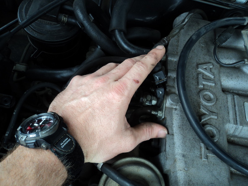

I pulled the wire off the cold start injector hoping it will help save gas until I fix my temp gauge...its very hot out here so I'm not worried about that but is this a good idea or bad?

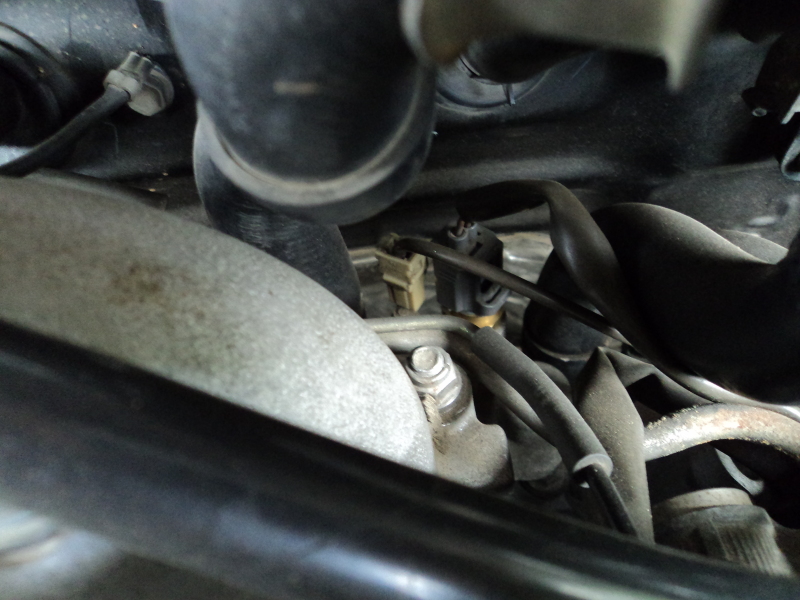

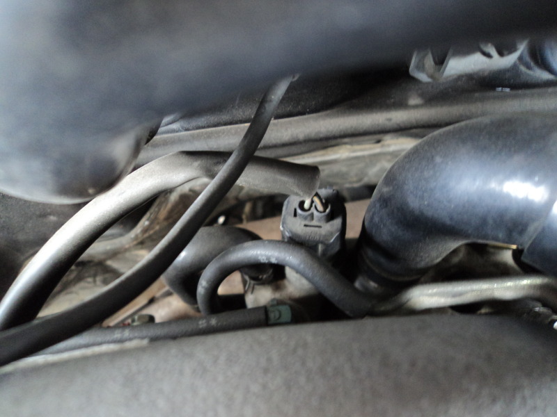

picture of my gauges please point to the temp sender unit so I can replace it...or is that my problem?
the other side

Please don't take movies while you're driving. We believe you when you say the speedometer and temperature gauge don't work.
Start with the manual. http://www.ncttora.com/fsm/1990-1995...e/combinat.pdf
I suspect (but I'm not sure) that you have the electronic speedometer; wired not cabled. First check to see if it's plugged in (back of transfer case on passenger side). If it is plugged in follow the manual to test the transducer.
There are at least three temp sensors in the coolant manifold at the after end of the block; only one of them is for the temp gauge (others are for the ECM). These posts may help you identify which is which: https://www.yotatech.com/forums/f116...-these-258925/ https://www.yotatech.com/forums/f116...s-3vze-224860/ Again, follow the manual procedure to check both the gauge and the sender.
You won't save any gas by disconnecting the CSI (unless something else is screwed up so badly the truck won't even start). It has it's own temp sensor/timer, and it only works when you're cranking.
All of these tests require a multimeter; if you don't have one you're wasting everyone's time (especially yours). Remember that the phrase "throwing parts at it" IS a perjorative; you don't want to be like that.

OK it's simple...if your gauge is not reading the correct temp then this is what you need to replace...looking under the hood, the one to the right(driver side) of it sends the temp info to the computer/transmission....very simple very cheap.now whats the one on the left side(passenger side)??
