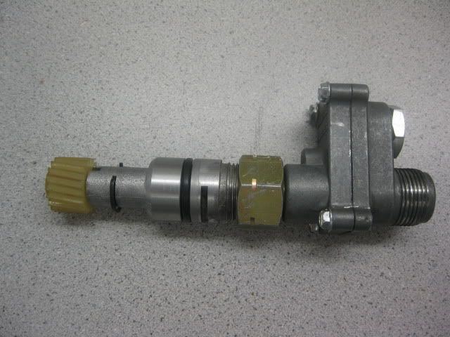

Thanks for your replies, I really appreciate the help. I had called my local dealership and according to the parts guy ..." Toyota made a 4cyl gear and a v6 gear, which did I want" He then recommended that I take it to a speedometer shop. They want $125 ... OUCH! I have 265/75/16 (32s) and 3.91 gears with a 5spd. I went from 31/10.50/15 to 265/75/16.
Old May 8, 2011 | 11:00 AM
The MAN's Avatar
Joined: Mar 2011
Posts: 246
From: Dallas, TX
you need a 27 teeth driven gear according to my calculations
the parts catalog shows a 27 teeth gear... it's 33403-39135... it's off a 1990 RN80 (short bed hilux/pickup) 4 speed manual RWD with the 195-70/14 tires and 22R-E....
I don't know if the RWD gear can go into the 4WD... but if you're willing to give it a try and your dealer is willing to take back any returns, go for it! I searched through many cars in the catalog and couldn't find anything 4WD that uses a 27 tooth gear, so if you're going to try something, that is probably the only one.... obviously, if you have RWD, the chances of it working is even greater in any case, it's still a lot cheaper than $125 if it works!
I'm going to go ahead and get the 19 tooth gear from the dealer myself... it'll take a couple of weeks to get in (which is also why I want to find used)

Call Chuck at Commercial Speedometer in Sacramento CA @ 916 371 5873 and have him build an adapter for you. It goes between the cable and the housing of your transmission. I found him from another post on here. Total cost shipped is about 130 bucks. Same day shipping. Instantly brought my speedometer to exactly where I was. Motorhome, just like you.
