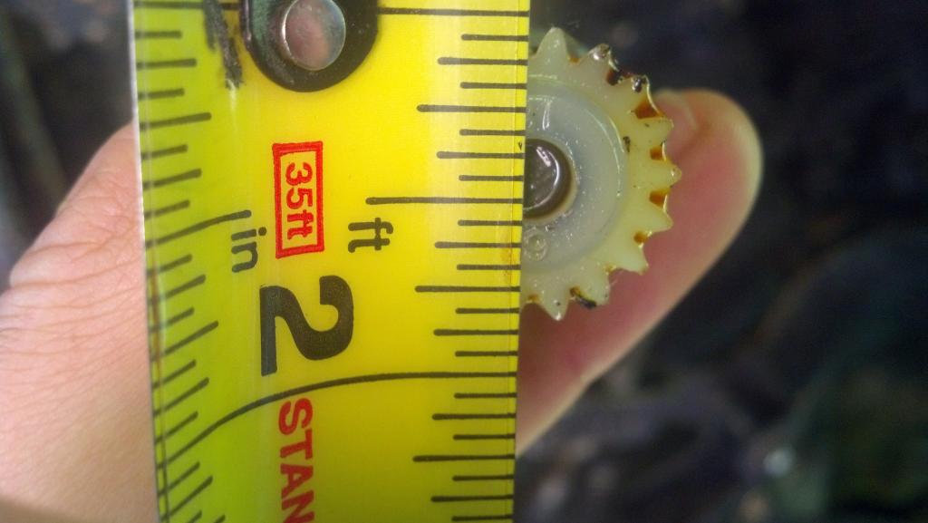

I can contribute these today before I slap the trans back into my '85 4x4. Same size?

Unfortunately mine is stamped 10 35. So I'll need like a 10 21 or something along those lines. Thanks though.
