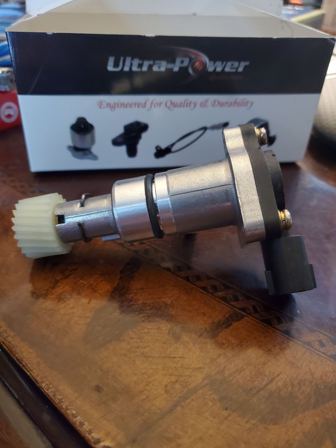

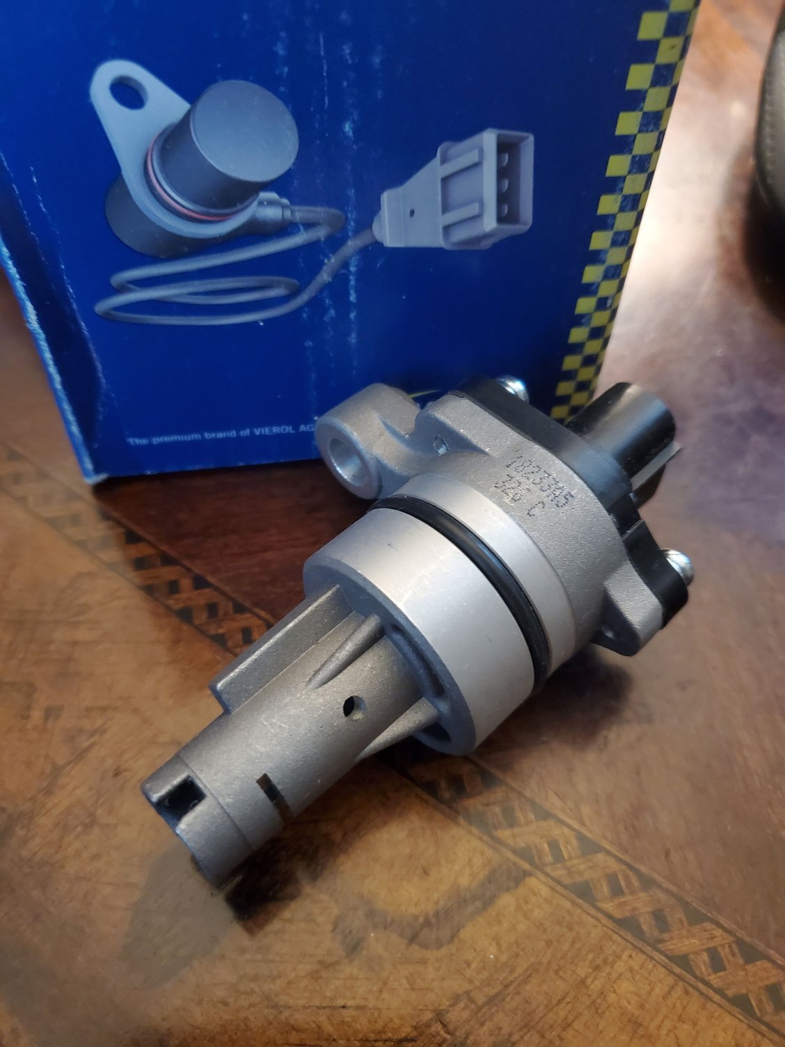

The second speed sensors I ordered and received today look like this. One has the plastic gear at the end, the other has a cast aluminum rod with a split at the end. Both are electrical. I am convinced that my 4Runner only has the speedometer cable, the vehicle speed sensor (replaced last week), and the 4x ABS Sensors at each wheel which I have not replaced yet, and the CPU ( not replaced).

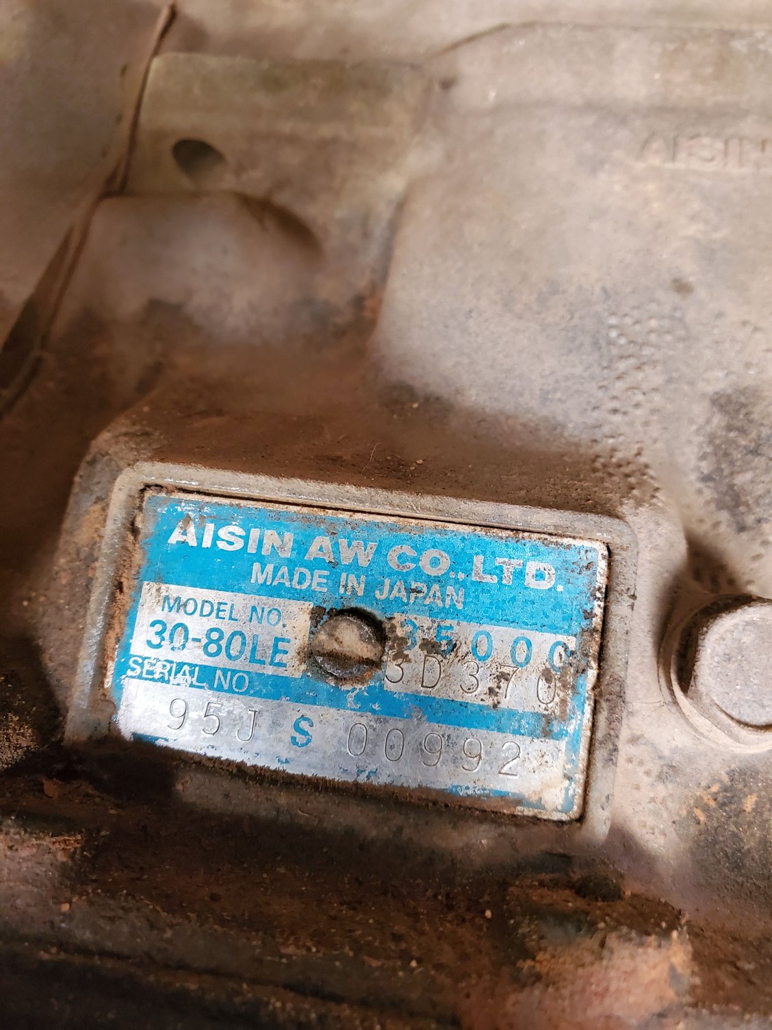

Trans. Tag

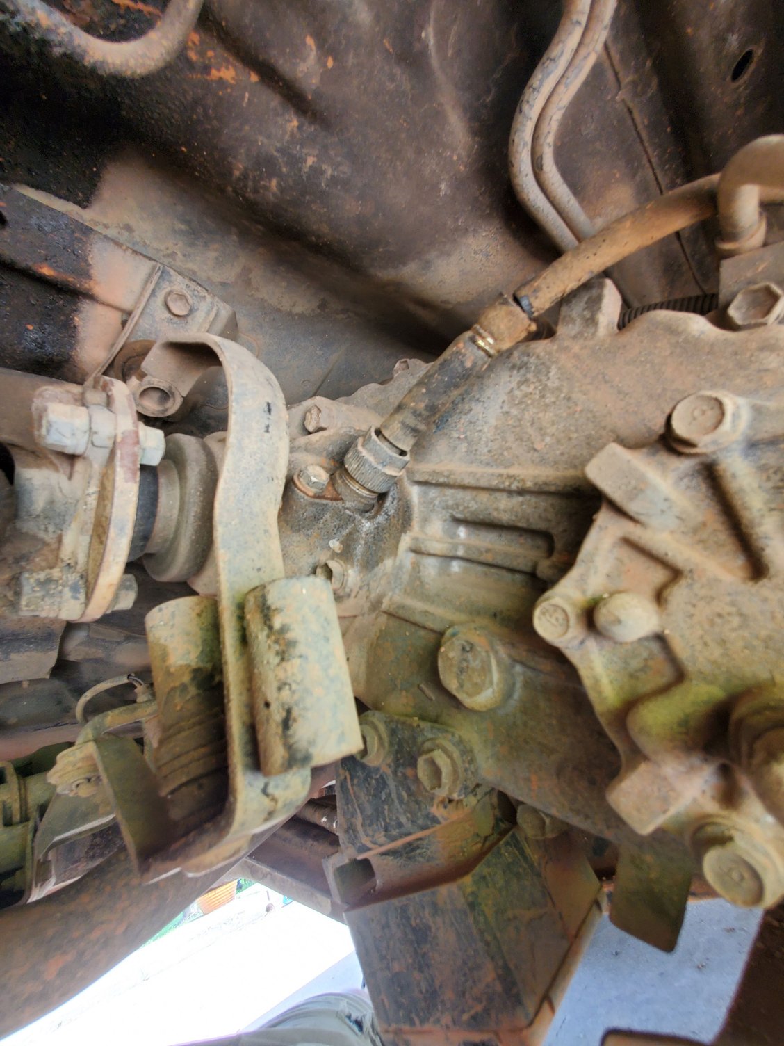

Speedo Cable in the cntr.

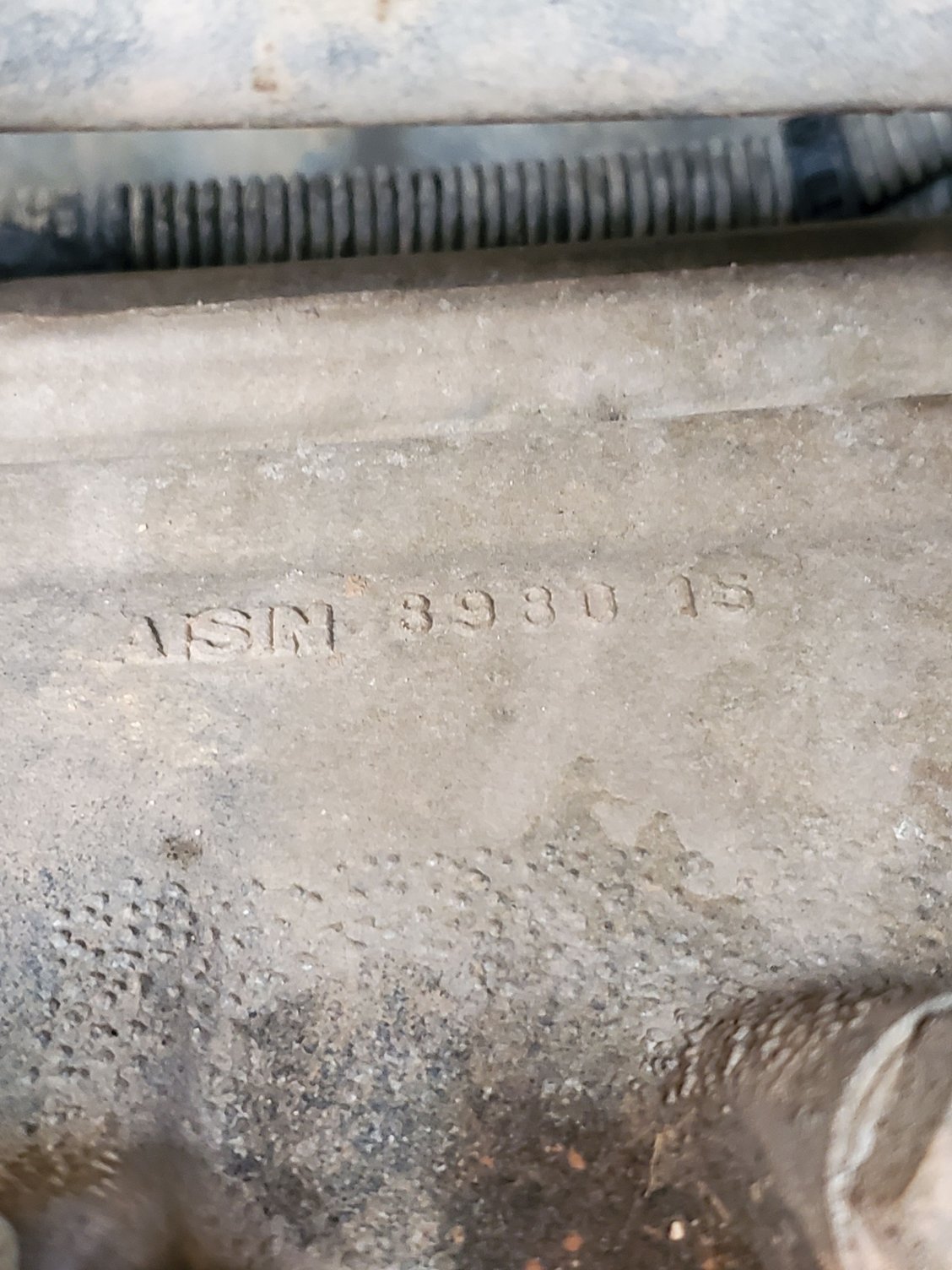

Stamp on side of Transmission housing, just in case...
Speed Sensor #1 that goes where I have a speedometer cable?? From RockAuto.com I think!
Speed Sensor #2, I have no idea where this goes, can't find it on my 4Runner.

Millball's description of how VSS1 works is correct. (Personally, I didn't think they used the cable speedometer in later model 4runners, but now I know.) The two sensors you purchased from RockAuto are for vehicles with the electronic VSS1; they have no use to you (well, don't throw the first one away, you could use it if you replaced the cluster with an electronic one.)

In your photo, your speedometer cable looks pretty ... tired. You can carefully remove it, and try spinning the gear with your fingers. I suspect you'll find the interior cable is broken. If not sure, you can carefully rig a drill to spin the gear; your assistant can check to see if the speedometer moves.

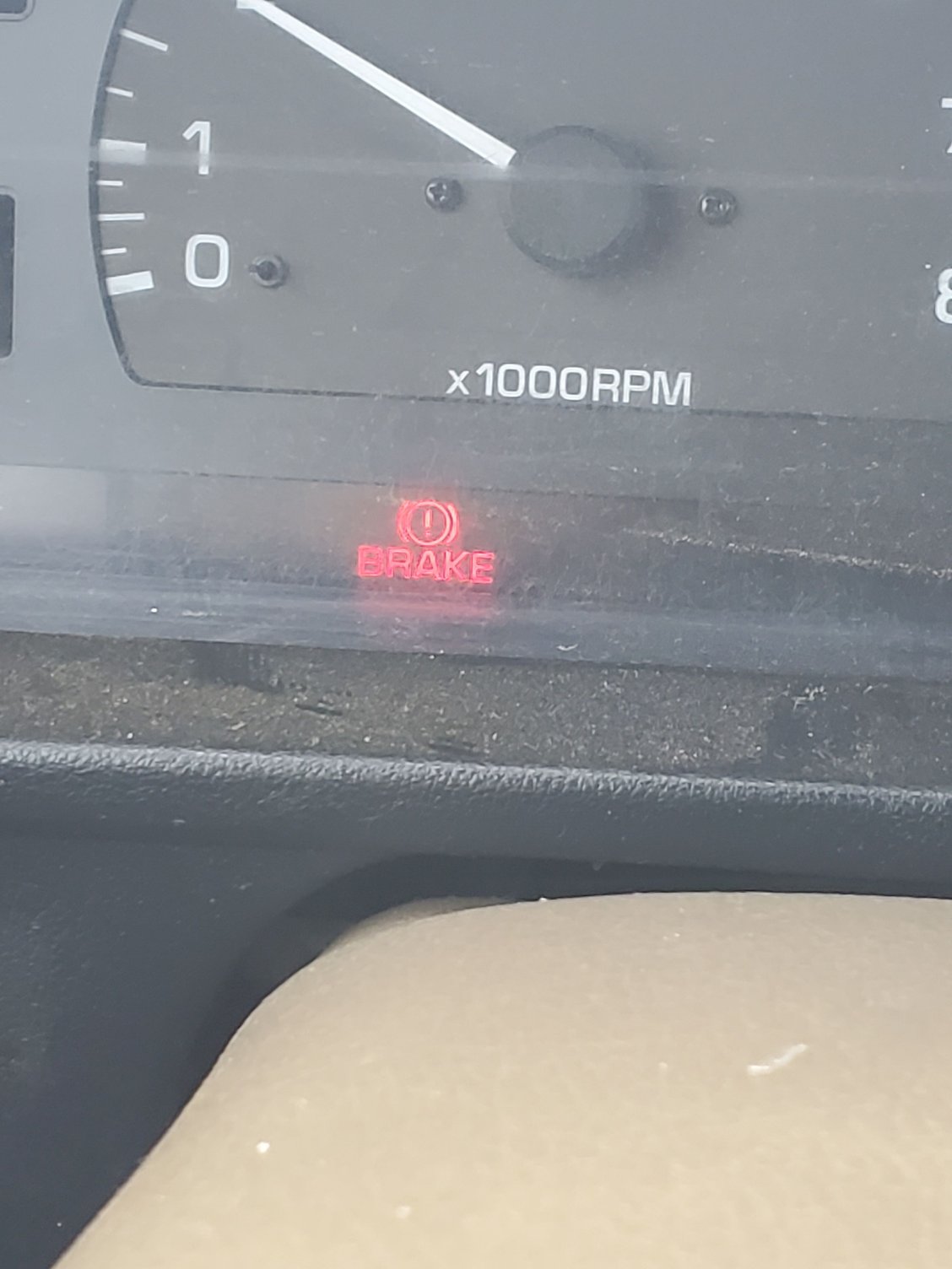

Dashboard assembly is all sealed up good still. My only remaining issue is the brake light comes on amd off. The brake light on the dash. Which prevents rise control from working. When the light is off cruise does work. Any ideas on that?

Found this online... There are two CC kill switches, one for the brake and one for the clutch. Pressing either pedal will turn off the CC. On auto tranny vehicles there is only one on the brake. However But the brake light I thought was just for the parking brake, but maybe this info helps. You have to make sure the pedals are fully returned including parking brake i suppose in order for the CC to work.

Yes, I think it is that switch. Because the pedal is fully depressed. I will look into it when I get off work. Thank you.
