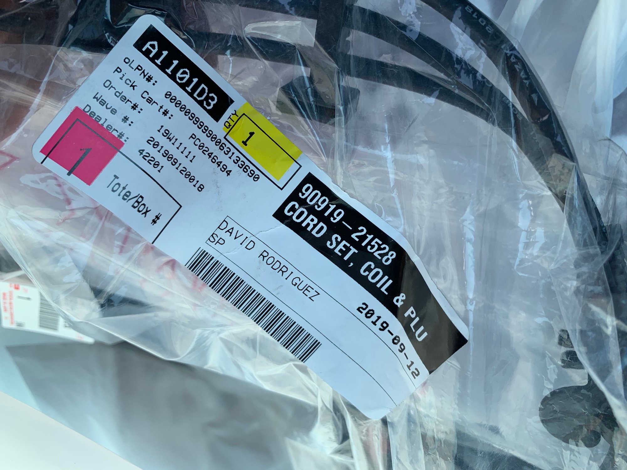

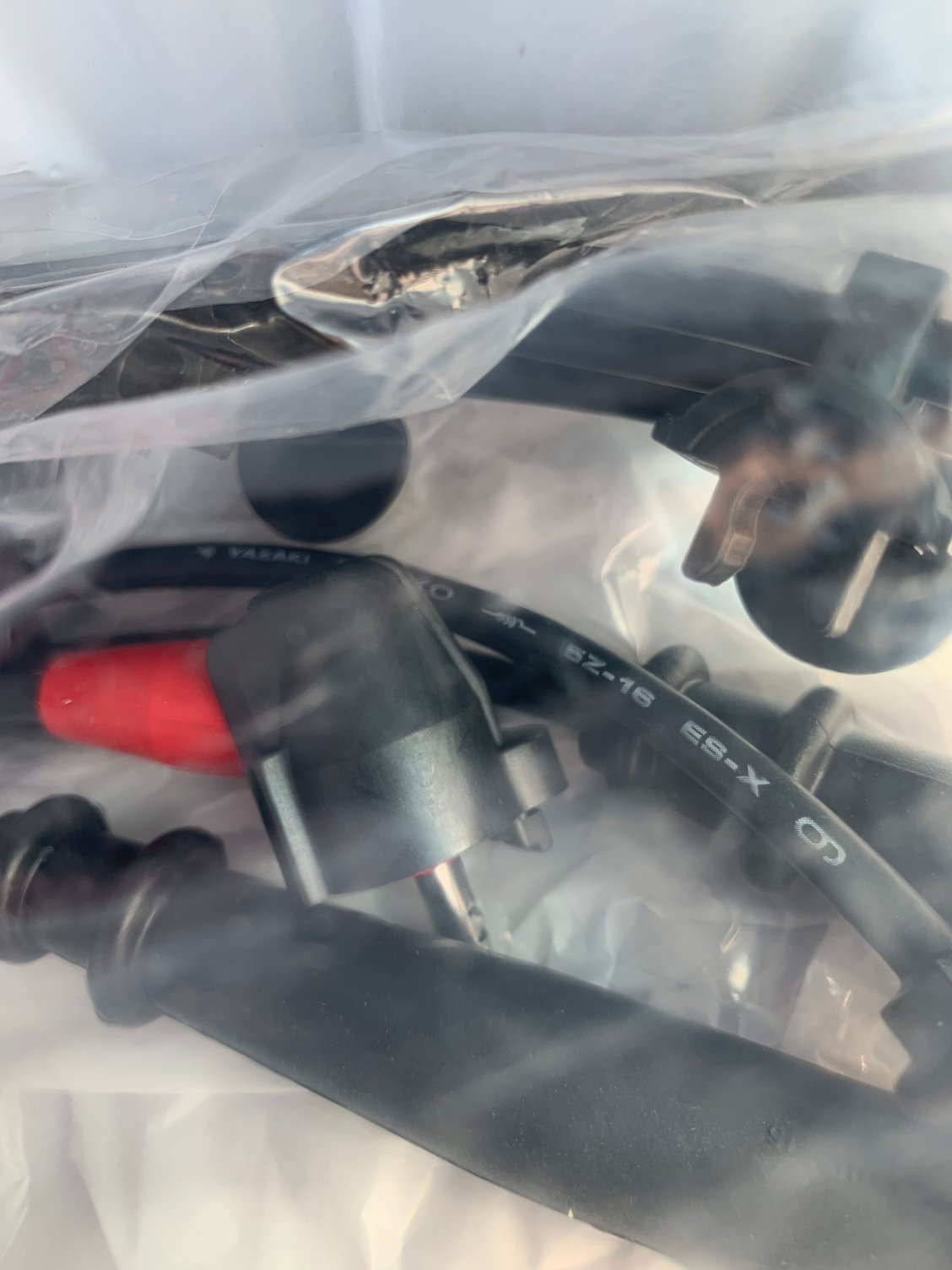

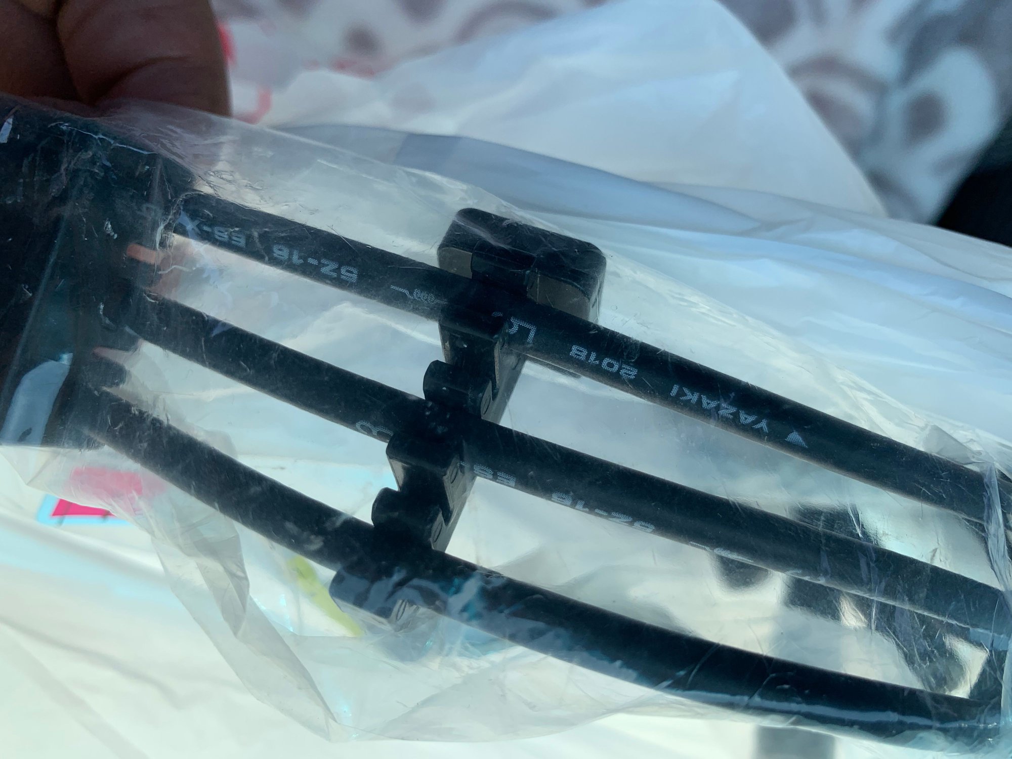

These are what came when they looked up my vin. They went in without a hitch with the factory plugs

Awesome!
Thanks for the pictures!
It looks like Toyota still uses both Sumitomo and Yazaki for their spark plug wires, depending on the engine and what deal they made with their supplier.
