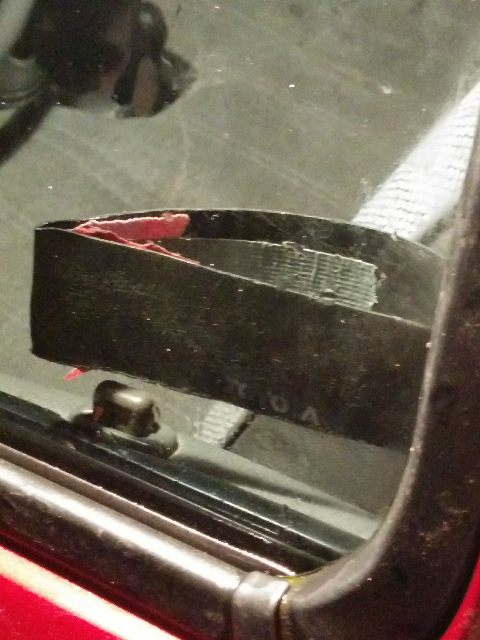

I got in!
I cut a one inch wide strip off of a crazy-carpet, 24 inches long. Folded it in half. Put adhesive sand paper in the crease. Put a plastic wedge in my door jam. Wiggled the device, crease first, through the weather stripping. Approached the plunger-style lock horizontally. Pulled one end of the device to make it curl towards the window, got it over the post, cinched it tight then pulled up at an angle...
Someone tried to break in with a screw driver.-forumrunner_20141211_192008.png
I took a video in case my description is lacking.

That's pretty creative. I don't think I'd have thought of that. One to put in the memory banks for the future. Good job!

Slim jim 2.0
