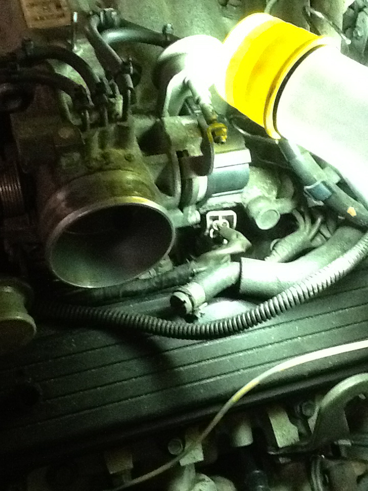

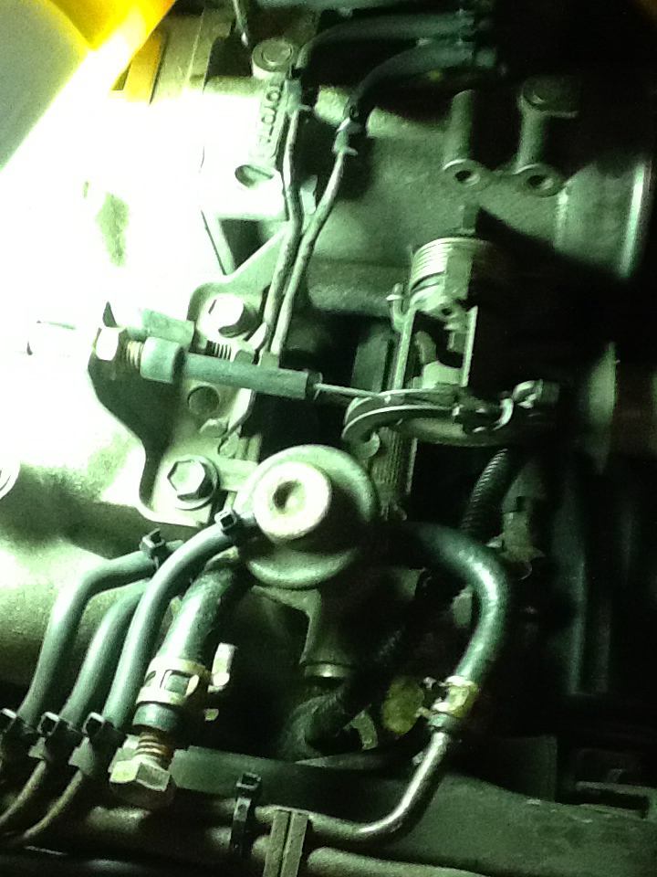

Status update: Just got home and took my AFM off going to start the process of pulling the TB off and checking the TPS/adjusting/replacing. I thought this was a little bit off, but I need your opinions. The hoses that connect to the bottom of the TB was plugged and not installed (see pictures) What does this mean?
Disclaimer: I'm doing this from my IPAD so I couldn't draw circles around the plugged lines but they are pretty visible!
What's ya'lls take on that fun stuff!?

Those hoses that should be connected to the throttlebody are cold engine idle up.
As the engine heats the coolant flows through a valve in the TB slowly closes lowering the idle.
It may be bypass because coolant is leaking into the throttle body.

Also, I did take it all out and clean it. Improperly maintained coolant seems to clog everything up. It's not that big of a job, take the throttle body out, clean every orifice and put it back with the coolant hoses. I would bleed the coolant out from that line that connects to the throttle body before connecting it back. I don't think this is causing your issues though.
You said the TPS was good, how did you check and/or adjust it? As per the FSM?
