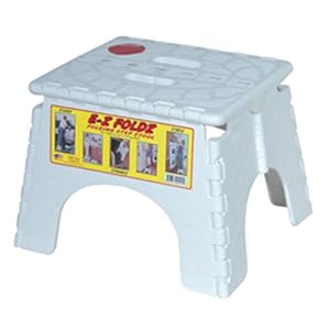

Other option I have used in my truck is a flat folding stool with a cord tied around it and the seat rail. Unfold the stool, use it to enter the truck, then reach down and pull it up by the attached cord, fold flat and stash under the front mat:
